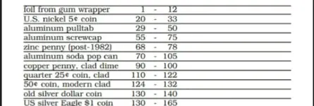

Hi everyone, headed out this morning for about an hour to the park with my TR running it in Program 4 "Prospecting Mode" when getting a signal I would switch to Discrimination with 0 Disc to identify target. I got a strong signal and checked its ID, it was reading 16-17. According to TR owners manual items reading 1-12 is probably gum wrapping foil, there's no ID info from 13-19 on the manual from ID 20-33 is the nickel range. It's tone sounded like Iron when ID'd. Signal was strong and steady 16-17 at 4" depth so I decided to dig, I said probably some gold ... :) ... But more than likely some trash I thought to myself. Digged the plug out and first thing I saw was one of its silvery end, got all excited and took out my cell and recorded my find, even posted it on you tube, since there's no videos of the TR except some guy doing some air tests of the TR and two other MDs, so I said what the hell I'm gonna start uploading my hunts with my TR.....lol. Any way it shows 925 Italy on its ends a beautiful reversible silver necklace and $.08 of clad change.....wow.... ;). My question here would be Why did it ring 16-17 on Silver since its supposed to hit high on tones and ID? Anyone using TR out there, help is appreciated. Just for info, I ID my wife's 10k gold necklace with gold cross and it ringed as a solid 18-19.

Silver is always being faked and sold. Not saying yours is. But if it was real it should have read up higher on your detector then it did. It rang up by iron or foil right? Try holding a magnet to it. If it sticks then it's plated. Just my guess.

Took it to the jeweler today but it was closed so I took it to the local pawn shop and had it tested, according to them its silver and the small stamp on it besides the 925 Italy is IX8 but they had no idea what it meant, its weight is 15 grams.

Just makes me wonder why it rang up so low on your detector. Id think silver would have been way farther up the scale then what yours was reading?
Good find though!!
The Time Ranger is not a relic machine. Relics rely on iron content. The Teks scale has the first 40 out of 99 a breakdown of iron conductivity. The BH Pros use 1-19 leaving 80 for a scale to break down gold and silver conductivity. The Time Ranger may use 1-4 out of 199 for iron, and progresses from 5-19 as foil. Using the gold and silver possibilities on the scale above the screen, you can see the gold starts from the extreme left where other units have the extreme left with a small section for iron before gold starts.
In this, the gold range (very small gold bits) could be IDed as low as 5 or 6 since gold can show up under foil. Remember, it's the conductivity that places the ID, as well as size. The unit is tuned to coin sized objects. So an aluminum can, can have the same conductivity as a silver coin, due to it's size. So partial silver, depending on it's arrangement, depth and other factors (part at 3" some at 2") doesn't add up to a coined sized silver object but more of a nickel conductivity or even foil. I bet, if you had circled "around" the necklace, you would have seen some different IDs. This is why "iffys" are checked from all sides as well as lifting and lowering the coil and inch or so. And also why most experienced hunters say to dig all iffys.
Some dig all as beep and digs. I can't stress enough when someone thought it was foil/pull tab and it was a gold ring. Jewelry is sneaky.

What if he rolled it up like a coin and ran his detector over it now that it is out of the hole? Wonder what it would read then? Should be in the silver range.........

OK. the size may be coin sized, then it has to have the same "conductivity" on the scale. A beercan can have the same conductivity as silver, even though it's not the same size. Make the beercan coined sized, it will ring up as "alum". You have the Deleon that does one more better using this method. The scale on each of the 5 segments are graduated, meaning the higher the height, the more confident the "segment" is for size. But if the ID says nickel and the ID says 0, it's iron. If you get a 95 and the silver height is low or medium (not at it's highest), the machine is saying "silver conductivity" but not sure of the size. This is the way Vince Guifford designed it to work. It's why the Deleon is one of the best coin machines made.

I never saw a silver necklace register in the silver range as it does not see the links as a mass,therefore a very low reading.

I agree. I've dug many smaller silver rings that rang up at the high end of the zinc range.
But like I always say, the only true discrimination is your two eyes. When in doubt, dig it up and look at it.
Garrett 424 is correct. The conductivity scale is set for coin sized objects. Role up the necklace, it has a good chance of a silver hit. Hit it in smaller portions opened up, and you get a less than silver hit, maybe zinc or even lower. Using pinpoint to size an object along with the conductivity stamp gives you only an idea of what it is. When in doubt, dig.
