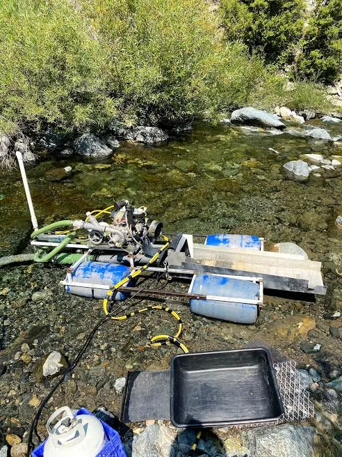

I made a lot of upgrades to my dredge, only thing left from the old setup is the sluice and some hose. I built the frame from scrap metal and use 4 to 6 15 gallon barrels for floatation.

I almost made a set of pontoons like that but opted for the barrels. If I was making a smaller dredge I would go with the stacked foam insulation, I read an article on making a fishing kayak from the stuff where after shaping it was painted with titebond and had an old sheet stretched over it, when dry that was painted over with exterior latex paint to make a durable skin. I converted my dredge to run on propane, runs quieter, starts easier, doesn't smell like a lawn mower, cheaper than regular gas and you can't spill it in the creek! I built my flare header from ABS and used a PVC quad-jet I built from Dave Franks Vortxrex plans.
I built a frame like Reed's that used my old dredge pontoons and and two 15 gallon barrels. It worked well but then decided to weld up a frame from some scrap metal that used just the barrels that has a smaller footprint and could tuck up the jet and flare under the motor for moving over rocks, it's not perfect and welded together requires dragging back to the shop for modifications. For a weekend hobbyist who likes to tinker this isn't that much of an issue but for someone who has to hike it out into a canyon to work a spot all season, where you bring it in spring time and drag it out when it starts snowing there isn't much room for that. You can run it in swimming pool but you don't know how it will actually act until its in the creek and its full of heavies. If I were to do it again I would have stuck with the conduit/unistrut frame.
