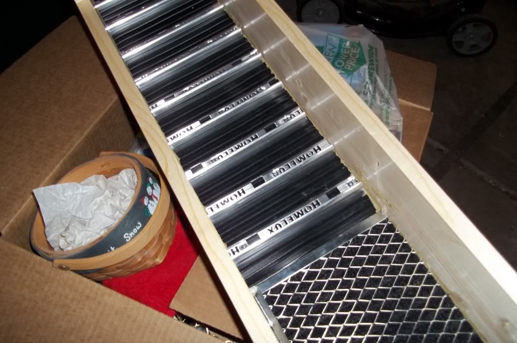

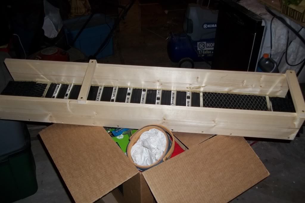

Was at Home Depot today and thought I'd pick up some materials to throw together a sluice box.
From reading threads on designs and materials, I had a pretty good idea of how to make one, but I didn't find the "perfect" pieces, but figured I'd try it anyway and see what I find.
The rubber mat is the one thing I wasn't happy with; it is too shallow from what I've seen.
I will use the sluice only for processing buckets of material I bring home from interesting places I find while metal detecting...
Feel free to critique as I have thick skin...
:BangHead: :BangHead: Expanded metal is to small and thin, matting is shallow, riffles are flat and worthless and have holes that create turbulence that will flush gold out, and to top it off it's wood so it will get nice and heavy when wet and warp on you. I would start over...
Hope this helps. Edson
Its not that bad at all for a first sluice and I am sure it will work fine once you make a couple improvements.
Start by sealing the sides of the riffles where they meet the board with something like liquid nail. Otherwise gold will wash out there. Next, make sure you water proof it. I prefer several coats of paint or decking wood stain then polyurethane. A higher raised expanded mesh would work better, but you can try that one and see how it does. I have used metal lathe mesh over grooved carpeting before and that trapped super fines very well.
Since you're new to sluicing, try to go out with someone who knows the ropes and can help you set it up, it will make things much easier till you get the hang of it. And take some pics!

I used aluminum tile edging about 1/2" high and rounded, I spaced them 2.25" apart. Is that at least OK?
I can get the proper expanded metal from Ace, and the local prospecting store has the V-rib mat, so that's no big deal, either...
