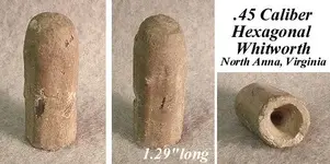

1.38 inches tall x .530 to .545 wide. It was hard to get a consistent width because of being 7 sided.

this maybe ? try to measure os dia on ridges of the lands on bullet
withworth "hex sided" smiper bullet * civil war era --very very rare
Someone suggested it was a regular miniball fired from a carbine and was considered a stretchy?
confederate whitworth "hex sided" type smiper bullet * civil war era --very very rare
I don't have it with me at the office, but this one is very close, and I've dug a few Enfields at this spot.
this is close i could figure based on your measurements with similar appearance
yes that is a issue but i may be wrong , hope some one else chime in with a hammer to nail for ya

Other posters here are failing to notice that your bullet's diameter-measurement (which you said is .530 to .545") means it cannot be a .577 Enfield, nor a Whitworth (all of which are .45-caliber).
Second:
Because TreasureNet has an option for viewers to enlarge of posted photo twice, I was able to confirm what I suspected from examing your bullet's "proportions" in your photos. You've definitely mis-measured your bullet's length. It is actually 1.038" long, not 1.38".

It is not a "stretchie" bullet, although may have been fired from a Breechloading carbine. A "stretchie" is formed when a soldier loaded an "oversize" bullet (such as a .58 minie) into a smaller-caliber Breechloader (such as a .52 Sharps Carbine). The oversize bullet will fit into the Breechloader's chamber, but gets squeezed-&-stretched when it it is fired through the gunbarrel's smaller-caliber bore.
For visual clarification, here is a scan I made of some "stretchies" I own. They are various .58 bullets fired through a .52 Sharps Breechloader's barrel.
I'm still working at researching to discover what specific type of .52 rifle fired your minie with 7-groove rifling showing on it.
Your fired bullet definitely was shot from a .52-caliber rifle. Although your bullet's diameter is .530-to-.545", those measurements include the rifling-ridges' thickness, plus about .01" of lead-patina.

i was guessing on that dia due to the way it was measured, and yes i know that it wrong but and my cw bullet experinance is zero if can nail it down go for happy hunting
with its diameter size being wrong for a whitworth -- they were 45 cal * --maybe its a a 52 sharps breechloader conical bullet
There are no Sharps bullets which have the wide, deep conical cavity we see on JDug's fired Minie-ball.
It cannot have been fired from a .52 Sharps Carbine/Rifle, because that particular Breechloader has 6 rifling-grooves ...and JDug's fired mine shows 7-groove rifling.
I'm still researching the various models of .52 carbines/rifles which had 7-groove rifling... but at the moment, I'm leaning toward the Perry .52 Breechloading Carbine (Confederate).
I thought something was fishy about that measurement. Forgot the zero. When width was .530 to .544 I sensed something was wrong but it just didn't click.
maybe it is from a Ballard no 7
