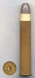

Not mini balls. From the right, round ball, then two what looks to be 45-70 bullets, and left of that my swag is they are paper patched bullets. They appear to be larger than the .45's, perhaps they are .50-90 Sharps, something like that. The round ball also appears to be larger, perhaps .50 or .54 caliber. The elongated bullets, if they are what I'm guessing they are, could date from the 1870's until now. I have a friend that shoots a paper patched .50-90 Sharps. The only way you can get an accurate ID on a bullet is to include exact measurements to one one-thousand's of an inch. Example, the diameter of a .45-70 bullet is .457.
50-90 sharps.webpThis is a 50-90 (.50 Sharps) with a .492" diameter bullet patched to .502" (slightly over bore diameter), over 95 grains of black powder
