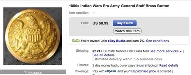

Here' one that does.
Daryl
Daryl
Thanks Daryl. Looks like a match. Is it real?? Does it show the back can you show the link?
Nope, this one is real. Backmark is Horstmann, Philadelphia. Has normal shank.
Daryl
Its a dead on match.
Yep but the back is like that of a repro. It's a quality button. You can tell that from the edge roll. Just the wrong way of attachment for a period button.
Daryl
