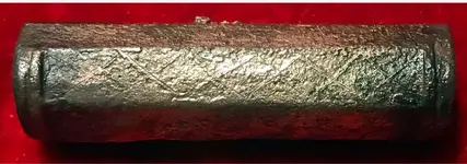

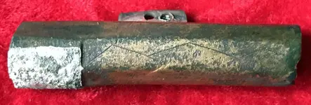

Piece 1: end cap for a Kentucky/Pennsylvania long rifle style gun

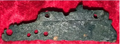

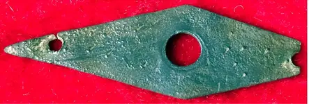

Part 2: I’m thinking this is a Little plate found on the sides of some rifles, notice the inner diamond of raised dots

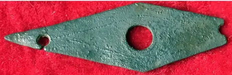

Part 3: not really sold on what it is but I have seen similar pieces inset behind the firing mechanism I believe called a thumb plate

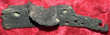

Part 4: flintlock lock plate

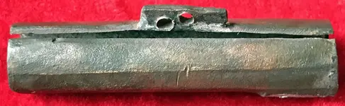

Part 5: ramrod thimble with similar geometric design as the end cap
Part 6: another ramrod thimble again same geometric designs

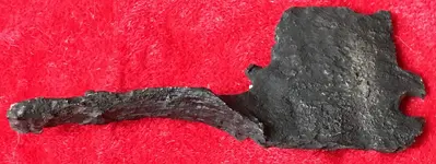

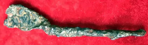

Part 7,8,9: triggers indicating atleast 2 guns the skinny one is questionable as a trigger but some guns had a second more narrow trigger very similar in shape

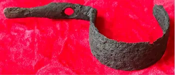

Part 10: a trigger guard found in the same general area but away from all other pieces on an adjacent hill side very possibly not related to other parts

So from what I’ve gathered so far, it’s a flintlock from the 1830’s ish based on other items. It was a long rifle, it was likely a trade gun owned by Native Americans based on the time frame, it was indian country in 1830 and other items support this. I’ve seen mention of “chiefs” guns which were more elaborate than the usual trade gun..... best guess based on all the above and the design on the “thumb piece” it could be a Lehman rifle.
I’d like to get a gun kit and build a replica to display near the gun parts but before I drop the cash I’d like to feel really good about my id.
Any input would be greatly appreciated but I understand there’s just not a lot to go on... including the possibility multiple guns are represented

The trigger guard is definitely from a totally different gun. I wish I could be more definite, but Pennsylvania long rifle may be about as definite as you can get. It would be easier to at least nail down a time frame if you found a trigger guard or butt plate, these changed more with time. My gut feeling is that it is a little earlier than the 1830's, maybe 1790 - 1800.

I agree with upper posts...you have parts from from different guns...the trigger guard is off a trade gun...the brass part from a long rifle....and definitely has indian scribble on it. Cool finds!! Native Americans didn't take very good care of White Man weapons..plus they used them for various other things also..like beating the crap out of an enemy when they run ran out of powder and ball..8-)

I’m not sure what you call these but I think my diamond served the same function

Any chance you could figure out the caliber based off the size of the octagon opening on the cap and a known thickness of a barrel?

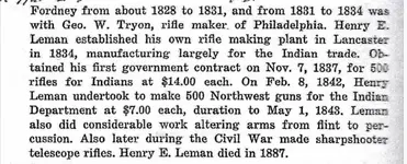

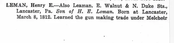

My grandpa sent me this small nugget that helps a lot.
I had no idea leman and tyron had paired up, that means in a way my two options above were the same, unless you want to split hairs. Also good signs that they also produced northwest guns (my trigger guard) and produced guns for native Americans.
May be all I can ask for an id since I spent another 4 hours with my giant coil and expanded my search area and came up with a .22 casing, two bits of wire, and a shot shell base that I thought was a coin or another flat button at first.
That newspaper clipping makes it all the more likely that Dixon's may be able to identify some of the parts you have found .They are located in Berks county PA I think .That is near to Lancaster County PA
