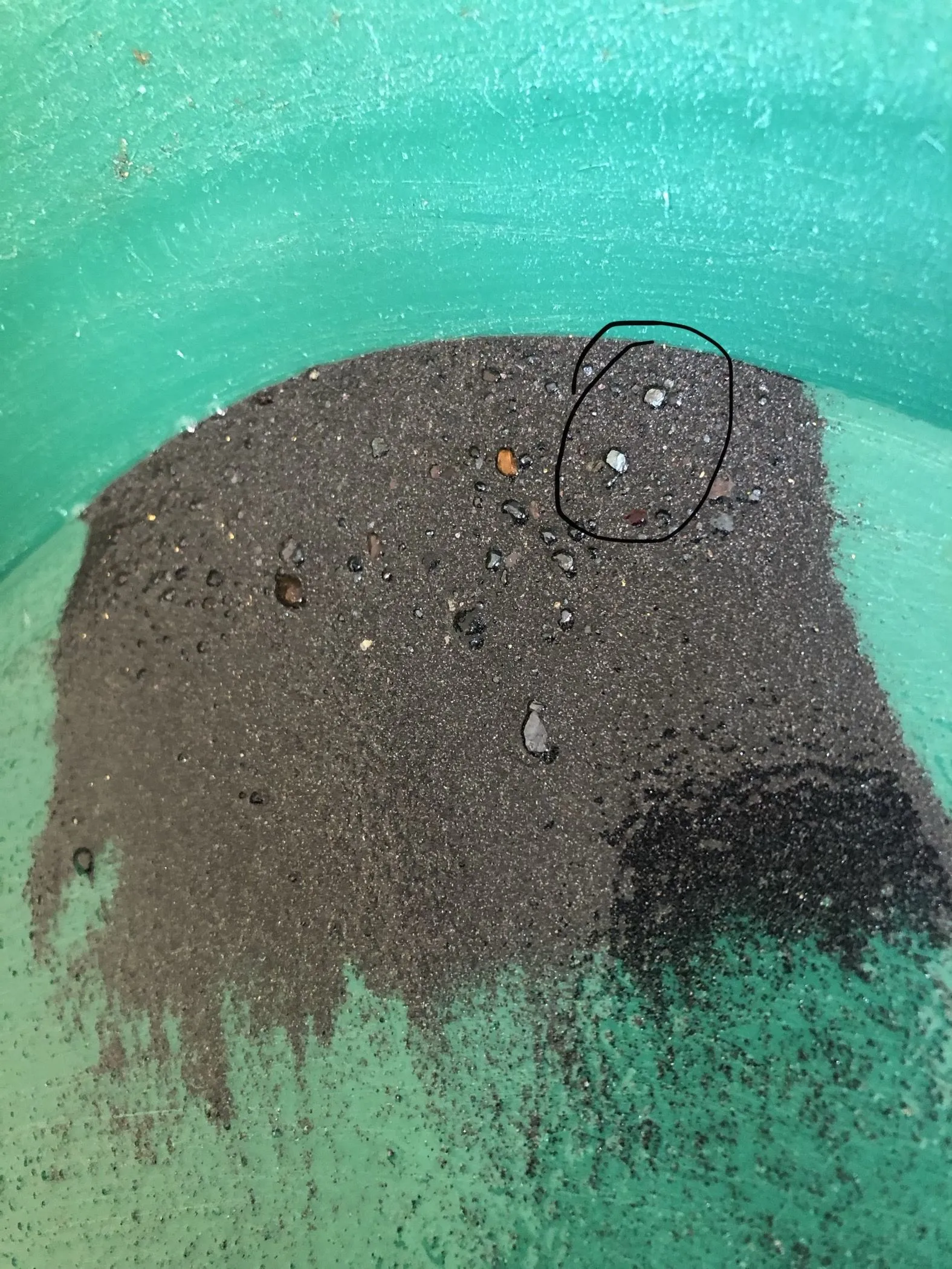

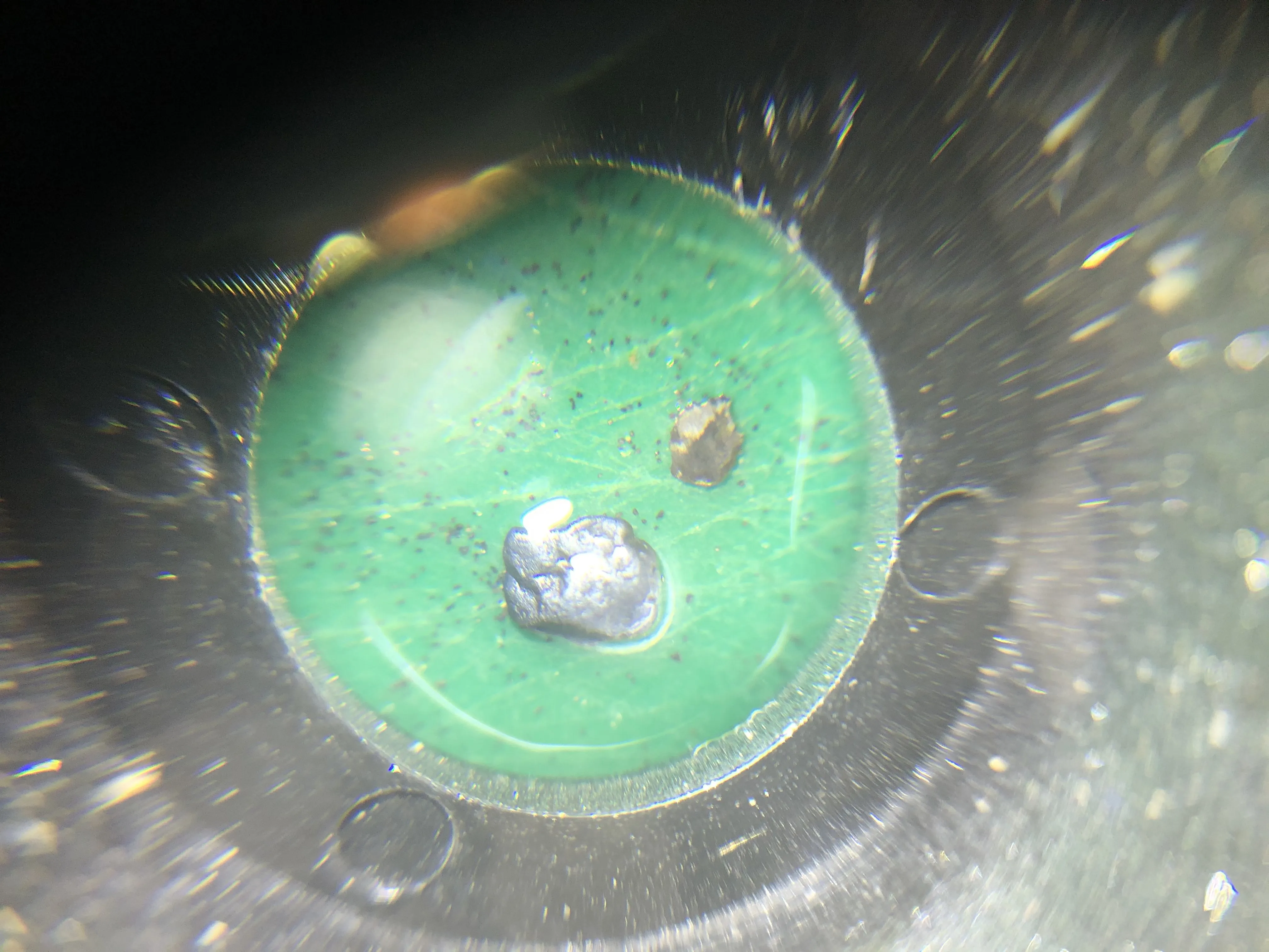

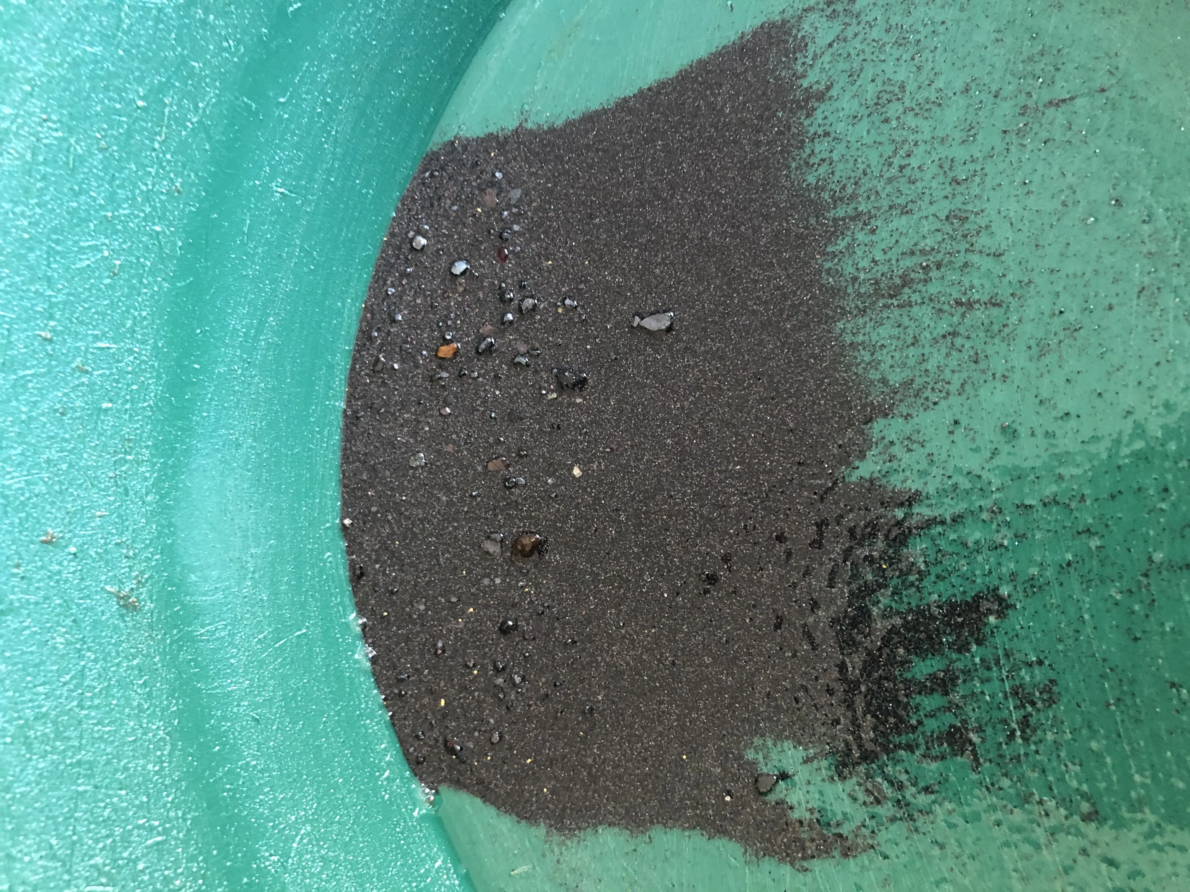

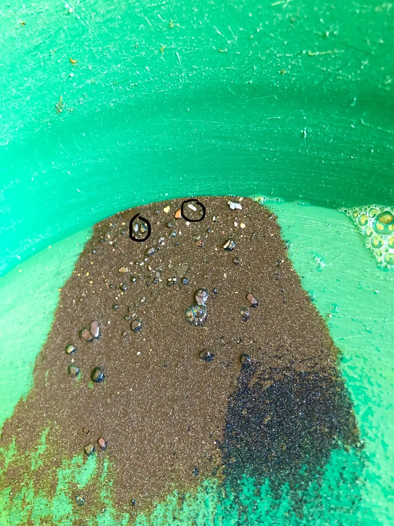

I’m an Ohio prospector. Everything of value here was once part of Canada and was kindly deposited here by glaciers. That being said it’s a real hodge podge of stuff. Anywho I often find the small iridescent blue flakes in my pans in pretty high amounts. I’m sorry the pictures don’t do it much justice, I figured I’d ask here in the off chance someone recognizes it.
Iridescent gunmetal gray / blue
Breaks in flat planes though thick chunks, not thin like mica
Very heavy, one of the last things to wash out.
Non magnetic
Thoughts? Galena? Maybe calco? Thanks gents!

Usually hardness and streak tests are the first thing to look at.
Does it appear to to behave heavier than the gold?
If it’s laying in the same band as gold, I’d say look into the possibility of platinum.
Those pieces look pretty angular which would be odd for a soft metal like platinum.

I’d say it acts about like the gold though it’s always much larger than the gold I get around here so not really apples to apples. I’m not familiar with platinum, not finding it anyhow. I can say it looks more like fragments off a large chunk, not nugget like. I guess I’d assume platinum would act more like a rounded nugget and less like a sharper, brittle mineral, or stone?
I don't know. Just going off your description "gunmetal grey and very heavy, one of the last things out of the pan".
Not many metals with S.G. near gold.
What happens if you press a razor blade on it? Does it fracture or dent the piece?

Platinum in nugget form is exceedingly rare. Given it’s a long way from you but there is a tiny little backwater of a town here in CA where platinum nuggets have been found. A place called Platina no less. Not to hijack your thread but my Dads best friends father worked behind the gold dredges on the Sacramento River for platinum as they would discard it as they didn’t consider it to be particularly valuable back then. I concur with IAMAUDIGGER about the razor blade test. Galena does seem possible. That was my first thought.

A Streak test is nothing more than a piece of unglazed tile (the rear side of glazed tile) and you have a known mineral and scratch it on the unglazed side of the tile several times to get a good color and then right next to your known mark ,scratch a equal amount of your specimen and compare the two to see if it's what you think it is. Good luck on your potential fortune ! :icon_thumleft: I would think every prospector has one of these mineral I.D. kits !!

44556D16-F2A8-4B35-884A-59FBA67B7635.webpOk. So it’s hard as hell. It takes a great deal of force on a razor to bust it in two. The streak is black, brownish black.

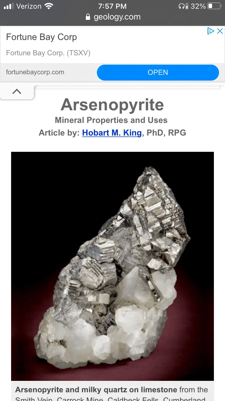

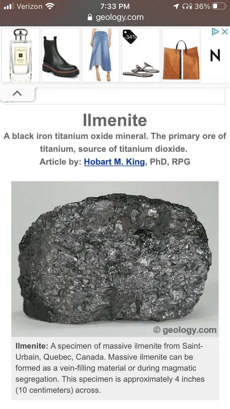

After looking around I’m thinking I may have found it?
What state was it found in? That makes all the difference.
Maybe...
Looks like the most likely culprit.
Ontario has a ton of silver. That’s my first (hope) I have my smelting stuff nearly together so I’m hoping to amass enough silver sulfides to get a few buttons of electrum.

I suppose while reading it’s possible to be a couple other options as well. They all seem to have pretty similar properties. The mystery continues.
