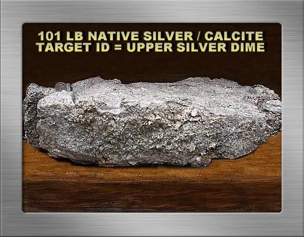

You will see some quality recoveries from this trip including a 100+ pound silver and calcite sample that understandably may challenge some readers’ sense of credibility… such finds possibly are outside their experience or awareness. Nonetheless, while we don’t see them everyday, electronic prospectors searching in this area have recovered quite a number of such large pieces over the years. I was fortunate to locate a deposit that yielded not one, but several large museum quality silver specimens.

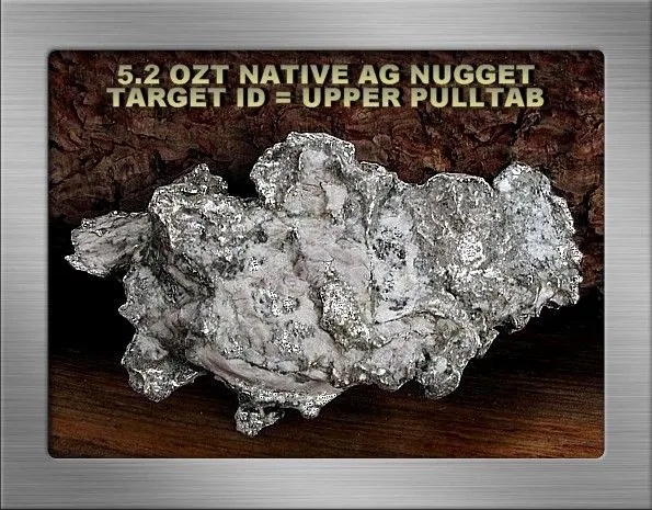

Rusted iron may reside at various target ID readings within the iron range, may jump in-and-out of the iron range, or may pretty much reside at various higher conductive readouts. Target ID depends on size and shape, coil sweep direction, state of oxidation and rust deposition into the surrounding soil, depth, and the ground mineral magnetic susceptible strength. That said, small iron normally occupies the iron range and larger iron tends to do otherwise in undisturbed field conditions. Deep large or compact iron is difficult to separate from large silver ore using VLF units until a good portion of the overburden is removed. Rusted iron produces a GB reduction but how much depends on conditions described above. For example, rusty drillrods in-situ can produce a dramatic GB reduction down into the low GB40s on the F75…an additional and valuable piece of information when evaluating target signals.

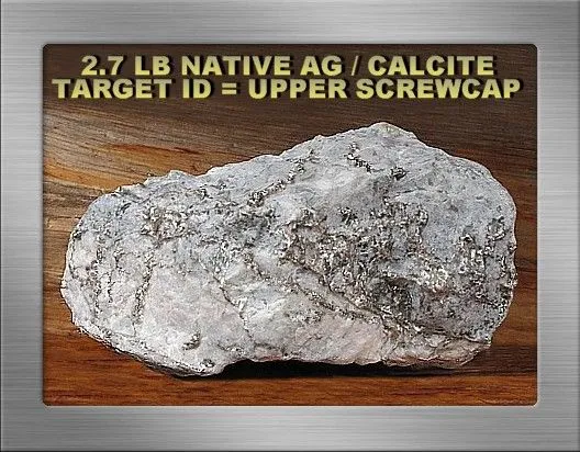

The photo below depicts a good quality silver specimen found with the F75…all-metal motion mode, bare threshold, near max sensitivity, GB at 86, Fe3O4 at 0.3% EM. This piece is quite heavy for its size. The areas shaded slightly gray indicate massive silver immediately beneath the surface…this rock would benefit from an acid wash to expose more silver.
By comparison, silver ores can read anywhere from the iron range to silver dime conductivity. Natural silver can also read in the silver quarter range, but these are so extremely rare as to be of no practical consequence. Whether silver ores target ID in the iron range depends on variables such as target size and depth, the proximity of iron junk, and the substrate’s ferromagnetic susceptible strength. When ground-balanced silver retains a positive signal and target ID, but GB reductions tend to be a bit unpredictable in tough ground and where non-silver inclusions occur in silver ores. Niccolite and cobaltite ores normally produce dramatic GB reductions. If you know you’re searching in even moderately tough ground…remove some material to acquire a stronger signal where necessary…and further evaluate suspect signals by sweeping the coil from different directions. Silver doesn't normally change, but elongated iron target ID usually fluctuates. When evaluating suspect signals consider the target size and shape in addition to strong target ID shifts that result from iron’s conductive and magnetic properties.

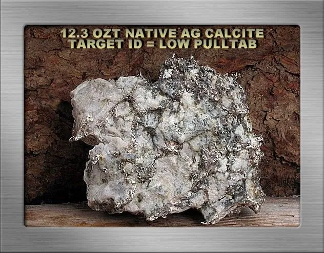

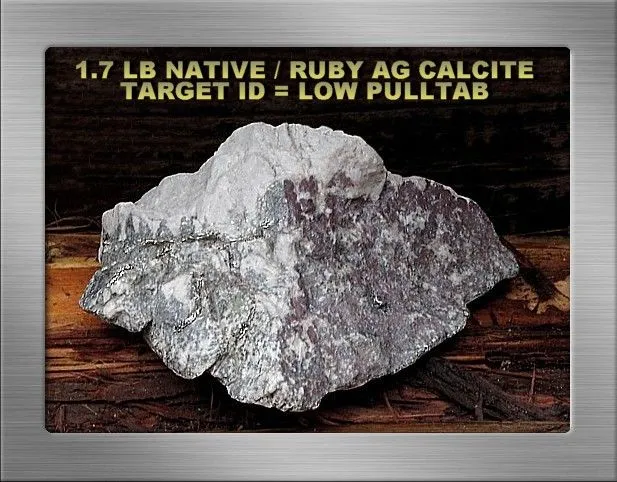

Below is a handsome example of ruby silver combined with native silver in a calcite matrix. Ruby silver comes in several forms. These are silver sulfide (sulfosalt) minerals with variable silver content on occasion combined with some minor copper replacement, sulfur, antimony and / or arsenic content. The silver content ranges from roughly 60% to nearly 70% by weight depending on the type of ruby silver. The ruby silver in the photo below is a fresh pyrargyrite surface that extends completely through the rock, whereas the reader’s left-hand side of the rock is comprised of native silver in calcite…a rare and unique specimen.

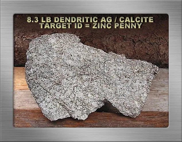

The photo below depicts a quality silver ore found at good depth…an Infinium hi-lo zero discrimination signal. This specimen is very heavy for its size and the native silver is quite pure. Although the specimen appears to be structured as a mass of veinlets…that is surface appearance only, as such do not account for the weight or a conductive readout in the zinc penny range.

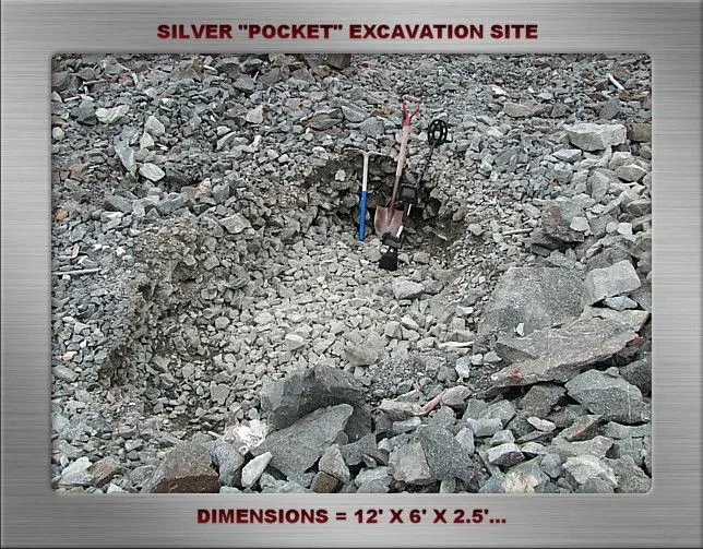

I increasingly tend towards a search strategy that might loosely be described as “pocket” hunting. Over tailings this might more aptly be described as locating spills or unintentional deposits of good material. This strategy accounts for much of my success searching mining camps in recent times.
Locate such deposits by searching sites most likely to have experienced unintentional dumping of good material. That means areas where valuable silver was handled and transported. Look for indications of surface veins, shafts, and storage areas where silver was graded, moved, and sometimes inadvertently misplaced. There is ample research information that can be accessed with modern computers, aside from local historical archives. Photos or drawings are sometimes available that show original building sites and other facilities at many of the now abandoned mining camps in this area. These are especially helpful to pinpoint areas where you may wish to focus your detecting efforts.
When a deposit is indicated, for example by multiple silver signals concentrated in a specific area…or visually as described below…do not be content to merely recover what are essentially surface signals and move on. You may well be standing over a good deposit that could extend down for several feet. Sample by removing some surface material and carefully recheck the excavation for signals. If there are no signals it doesn't hurt to repeat this step…yes it is hard work but well worthwhile if paydirt is located. I can’t emphasize enough to take your time with this job and be thorough. Below is a fine example of typical quality silver ore recovered from the excavation site portrayed below.
Some potentially good sites have scattered concentrations of small calcite samples on the surface, some containing a tiny thin vein or two of silver. These may well indicate better pickings below but tend to be overlooked by hobbyists using any form of VLF discrimination. Over such ground you are unlikely to find anything worthwhile for the first foot down. Good “detectable” pieces in the top foot likely have already been removed. If a site has potential you will tap into it below that layer. Again, remove some material and scan with either a ground-balancing PI unit set to minimum pulse delay with a smaller coil more sensitive to disseminated or spongy ores…or preferably use a properly ground-balanced VLF unit operated in the all-metal motion mode.
Admittedly this is not an easy task…particularly for the novice electronic prospector. Intensive detecting and collecting pressure for 40 years has removed most of the easily found surface indicator signals at most readily accessible sites. But if you happen across such spots…make an effort to investigate. Sometimes we forget lessons learned when searching for non-metalliferous minerals where our primary search tools are a pick, shovel and screen. In concert with a metal detector these tools can do wonders in silver country. The photo below illustrates that I do exactly what I suggest you do at potentially good sites.

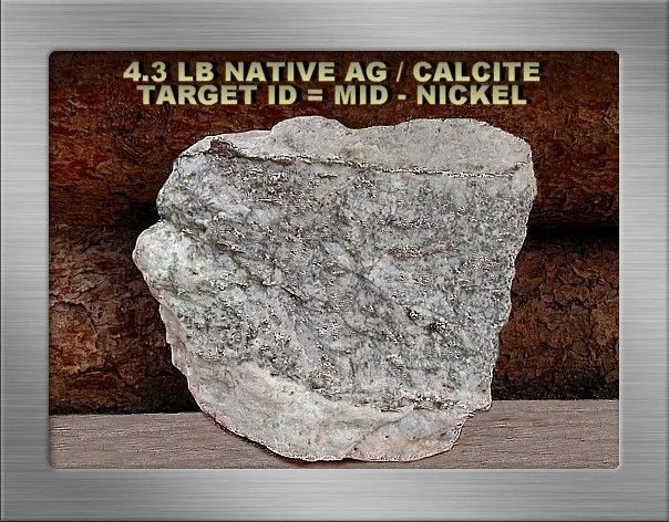

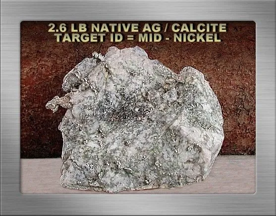

The handsome silver ore below is another typical quality piece found at the above excavation site this past autumn. It is rich with native silver…but isn't terribly photogenic. Many such ores ranging between a few ounces and several pounds were recovered at that site…a very productive deposit and certainly worth the time and effort required to sample and excavate.

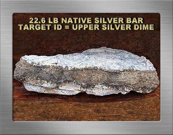

The large specimen below was recovered from a well-drained area not too far distant from a locally acknowledged source of silver floats. Glaciers stripped material from native silver veins and deposited that material in float trains. Some floats appear to be inexplicably distributed at random throughout the area like so much flotsam and jetsam. Scattered silver ores right on the surface have been recovered over many decades dating back to the area’s pioneer days. Electronic prospectors have enjoyed good success at locating various floats…occasionally museum quality finds. All floats are not native silver but commonly are comprised of other minerals, for example cobalt and various arsenides. Searching the outback is all too often rewarded with digging abundant manmade junk, some now residing at good depth.
I didn't anticipate finding such a large piece and almost passed over the signal thinking it would be buried trash. Finding it gave me an exciting few moments, but it was terribly frustrating trying to get this piece out of the bush, and such a relief to finally get it safely into my truck. It was cleaned with a rotary tool and diamond bit that removes all surface silver flakes and horns except the most sturdy. For perspective a silver quarter is placed on the top left side about halfway back.

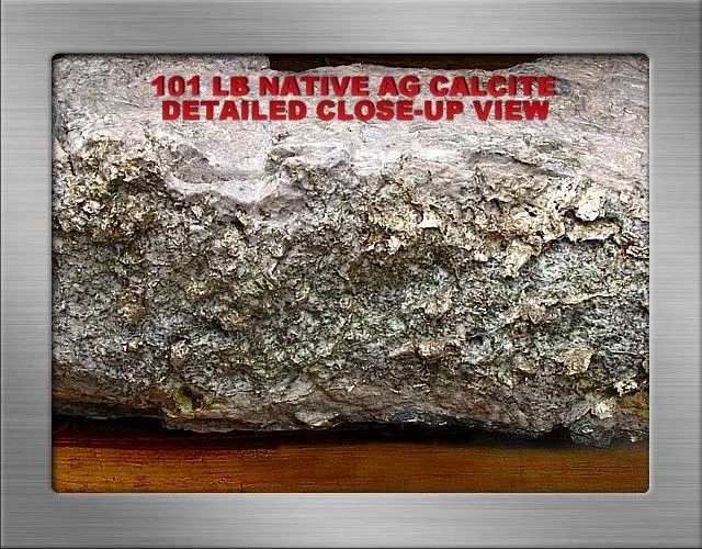

The ‘close-up’ photo below takes a better look at the silver detail unavailable in the above photo due to the sample to camera distance…by using the camera’s optical zoom feature. The rock is inundated with thick coarse silver that protrudes from almost an inch on down to the tiniest veinlets and horns. The vein material travels completely through and around the rock. Other than one narrow section on the reverse side, there is nowhere to place your finger without it resting on silver. Checking it with a multimeter, there are no pair of silver contacts on this rock that are not electrically connected.
