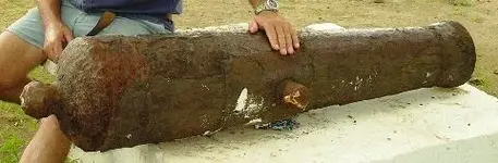

Cannon markings

Cablava
May 24, 2005
517
19
The final makings "9-3-0" on the bottom of the cascable indicate the weight of the cannon is 9 hundredweight, 3 quarters and 0 pounds. Since a hundredweight equals 112 pounds and a quarterweight 28 pounds the total weight is 1092 pounds or about 496 kilograms.

Eborac:
The hundredweight was part of a system of measures of weight that
was in commercial use throughout the British Empire from ancient times
(as legally defined in 1340 by King Edward III, the hundredweight was
equal to eight stones of 14 pounds each)--- into the 1970s.
The "P" probably stands for the name of the foundry; British, I presume.
Knowing the gunfounder's marks, if any, at the end of both trnuions, might also shed further light on ID-ing this piece of ordnance.

hi again,
many thanks for your info. the cannon was found about 10 yrs ago by a local cray diver who does not want to reveal the location of the wreck. it has not received any treatment and is gradually breaking up.
there are no other discernible marks other than those in the earlier pics. is anyone able to tell the country of origin of this cannon ?
regards HH

Eborac:
I'd guess (really, just a guess) that it's British. You might try these sources to confirm one way or another:
Brown R.R., 1989, Identifying 18th-century trunnion marks on British iron guns: a discussion.
Elvin J.G.D., nd, British Gunfounders 1650-1850.
Ffoulkes C.J., 1937, The Gun Founders of England.
Lavery B., 1987, The Arming and Fitting of English Ships of War 1600-1815.
Don......

This is a British Cannon with the proof mark more visable. Also British cannons had a broad arrow on them.

thanks all for info & advise. I'd dearly love to preserve this cannon if only I were allowed to. It is located in a community where the preservation of artifacts does not appear to be considered a great priority. I was informed that some dinner plates were recovered also with the cannon but were viewed as old junk and later discarded. I am hoping to convince some of the people involved in the rcovery that any future finds be made available for preservation. regards HH

Eborac (HH):
The crown and P go together to assure the purchaser that the gun had been proved (tested to a standard). You might get more information on this gun by contacting Nicholas Hall, Keeper of Artillery, Royal Armouries (UK) at:[email protected].
If you do, attach a pic of the gun--full length--besides a measuring index (a ruler will do).
All the best,
