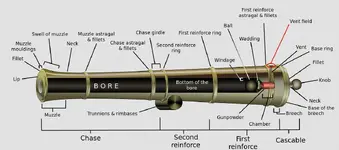

I see nothing that indicates this is a cannon muzzle... Upon first glance this did not even strike me as a cannon part.

The main one being... the muzzle ring is incorrect... which I must add... IF REAL... would have been the reason for "failure".
Also... The age is incorrect.. of the metal that is... The rust is incorrect... Looks to have been painted or galvanized OR ? as well.

I will go ahead and add my "refrained" observations that lead me to believe this is not a real cannon or a cannon at all...
The parts that are incorrect for a cannon are as follows...
#1. The Astragal / Fillet is incorrect.
#2. The Swell is incorrect.
#3. The muzzle moldings / lip fillet / face is incorrect
Small bore for a cannon?? unless it's a toy one.

This generally would not point to any conclusive decision of its "realness" as cannon were produced in all sizes.

I can believe a signal cannon but garden cannon doesn't fit do to the location.It also seems very heavy.Could you tell me what is wrong with the fillet,swell,and face as you did not elaborate.To me (cannonly deficient)it looks like a cannon.
I'm still not seeing definitive proof either way as many cannons I've viewed have no or insignificant swell .
