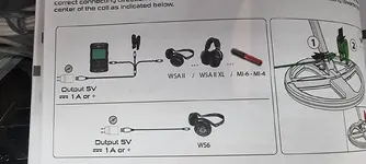

I only know that it works fine... Check page 30 of the user manual! Look at the picture carefully; you will see the three way cable; one of the leads ends with the "cannon plug" and the red arrow/line inidcates that it is charge/data - the second end of that red line points to the usb/c type single cable and is also charge/data.. Notice that the two remaining ends of the 3-way cable are marked "Charge". The three way cable is made to charge all three portions of the Deus 2 at one time from one charger! The single ended "C" cable is only required to pass data, it is used to update the headset!

The 3-way cable will not work to update anything but the remote control. Must use the single cable for that. The only portion of the 3-way that passes data is the round cannon plug going to the remote control. Not sure why XP did that. Page 38 of the manual also shows the single cable for updating the headphones as well as the pinpointer..
