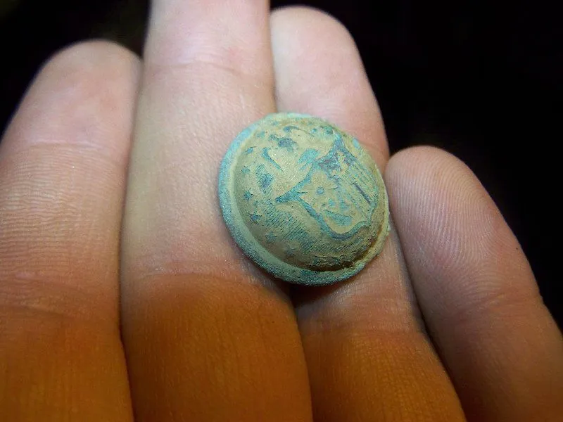

Civil War New York button cleaning. Aluminum Jelly @ its best !
DirtyMike
Feb 10, 2009
898
106
West Virginia
Teknetics T2, MXT, TDI, Tejon, AT Pro

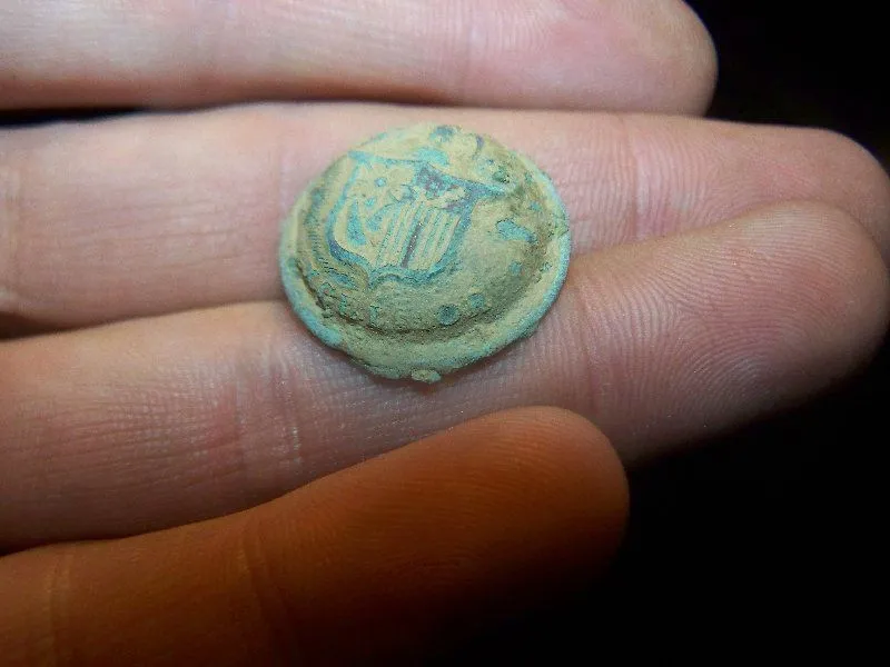

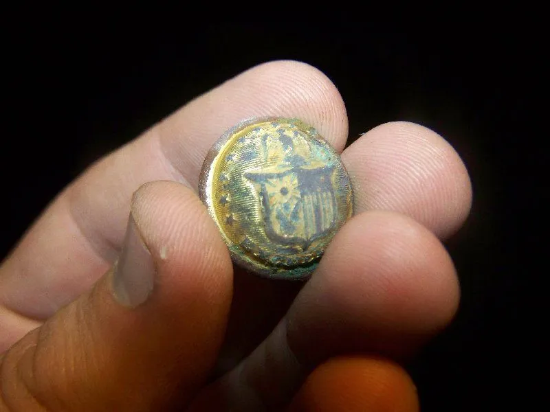

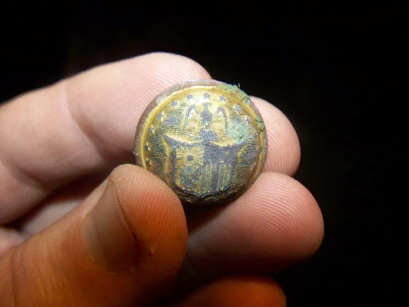

Light application of the aluminum jelly with a soft bristle tooth brush. Soak for a few minutes then rinse with water. Another light application, soak and rinse off. Dry carefully!

Dirtymike, if you give a button like that a good cleaning with peroxide first to get the tough crud off, all the green will be gone after the jelly treatment. When you go to something harsh right away you often can't get 100% of it off because exposure time is always on your mind. Also, the peroxide is a very good test to see if there's enough gilt to want to use something like the jelly. After the hp brush and soak, if you determine the button is better with a green patina you just continue to clean but let air dry. It's a good step because some buttons are a total gamble to use the jelly on, and an even green patina is often much nicer than randon spots of gilt.
IP, Thanks so much for the help. I have enjoyed your post and learned alot from them. I will be trying out this method tonight. Thanks again. Mike
