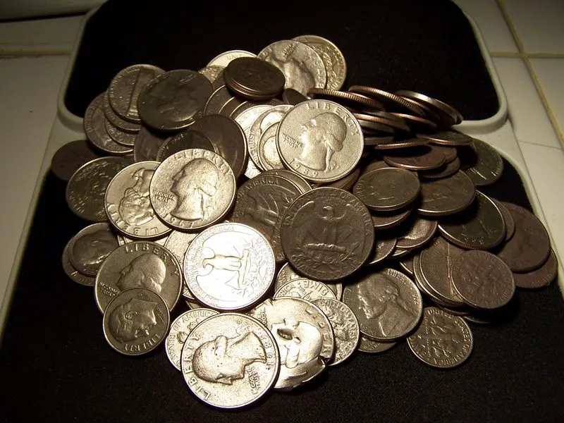

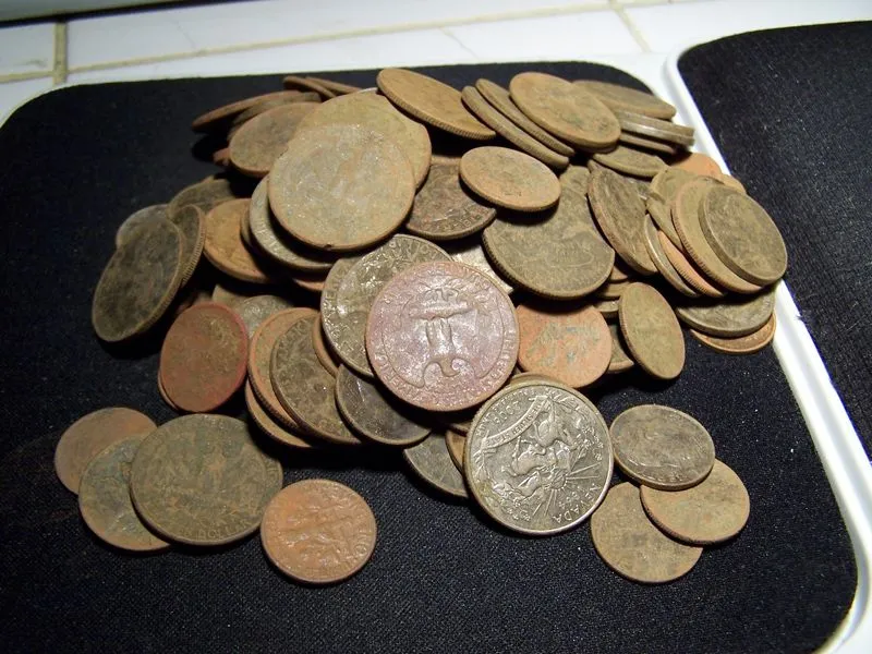

I tried cleaning some of my clad with a rock tumbler today and I think it came out pretty well.
I put equal amounts of coins and white aquarium gravel in the tumbler and covered it with about
an inch of water. Then I put a couple squirts of dish washing liquid in and ran it for twenty hours.

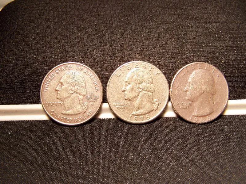

Some of the coins have a slightly frosted look, I'll try twelve hours next time. Thank you Gibsondan
for the idea and the video showing how to do it.
Joe

Not bad at all! Thanks for the before and after pics. I need to get back out and detect some so I can have coins to tumble clean!
They sure came out looking OK to me. That is one thing on my wish list for my B-day and X-mas. I really have a bunch of coins that really needs to be cleaned.

It came with one extra belt. I did a load of pennies this morning, I only left them in for five
hours and they were perfectly clean, not like a new penny but all the crusted dirt was gone.
Joe
