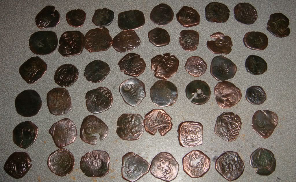

When it comes to Roman or Medieval coins... let's just say I've been yelled at by MANY collectors.
I like to enjoy my coins rather than have a pile of round rocks that I don't have the time or money to clean properly.
A drill press and a soft wire brush makes the coins look new in seconds!
DO NOT DO THIS IF YOU COLLECT FOR VALUE! This literally takes probably 90% of the coins value away.
And no, I don't do this to my US coins haha
Here's a batch of "uncleaned medieval coins" I bought off of ebay post cleaning:
