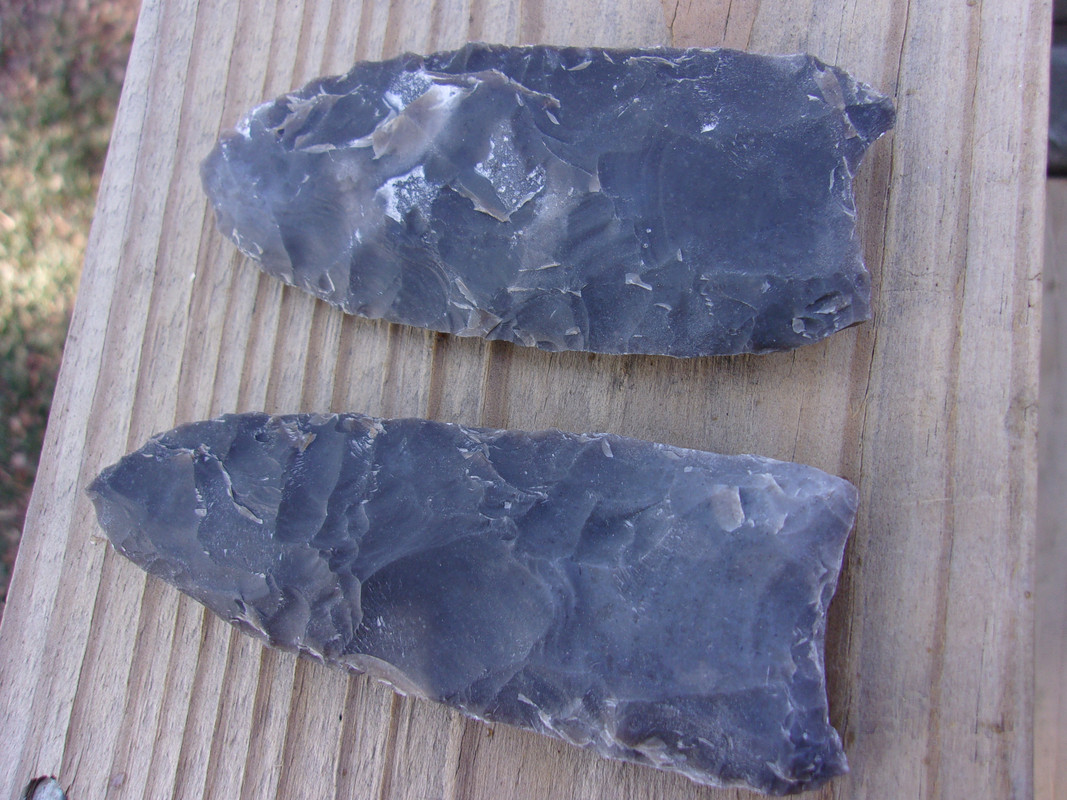

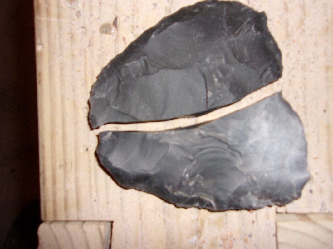

A one time experiment many years ago with "Clovis platters." Raw Georgetown. I started out trying to drive the largest flakes I could off the biface using direct percussion with an elk antler hammer, testing the idea of the biface as a flake core. Once I got to a width to thickness ration of 8:1 the next attempt at a usable flake overloaded the system and the platter split.
Maintaining as much length and width as possible I used an antler punch to make two fluted knives, thinking that was the next logical step. If used future re-sharpenings would eventually morph these into fluted projectile points:
Sorry no pictures of the flakes. The board the finished pieces sit on is a 2 by 6.
Thanks for sharing this! I have never seen a modern day knapper attempt one and have always been curious of the results.
Interesting failure break. The platter splits a guy sent me from Texas -- apparently intentional -- start with a low-angled break that rolls into a right-angled one as it traverses the platter. Yours is 90 degrees end to end.
