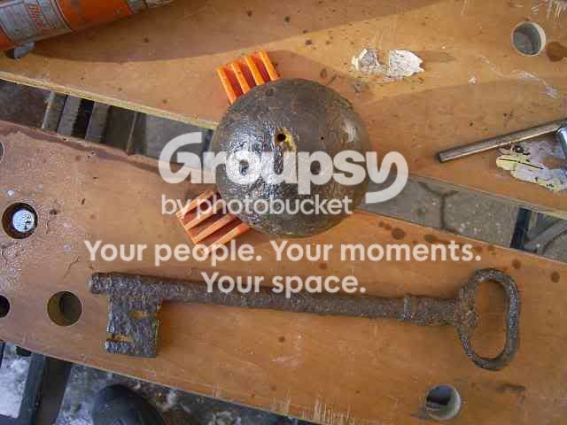

Dried out the relics near my wood oven then cleaned them with a wire wheel and drill. While cleaning the cannon ball I found a small hole visible in the picture, that made me a little nervous but I had already heated it to around 300F/150C. After cleaning the iron, I reheated the relics and placed them in a wax bath.

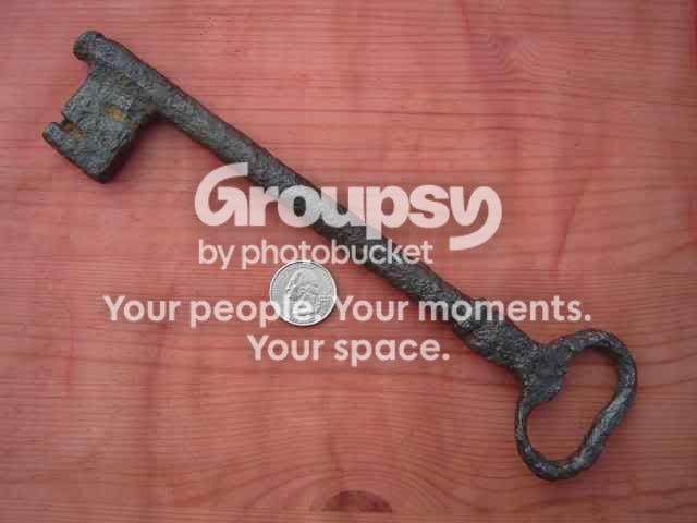

This large skeleton key turned out nice, it is 9.5”/240mm long. Not sure of the age but I would think before 1750. The American Quarter for size.

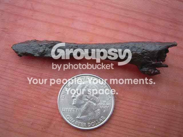

A cross bow bolt tip probably early 1600s. I didn’t clean it other than water and a soft brush. It also came out nice.

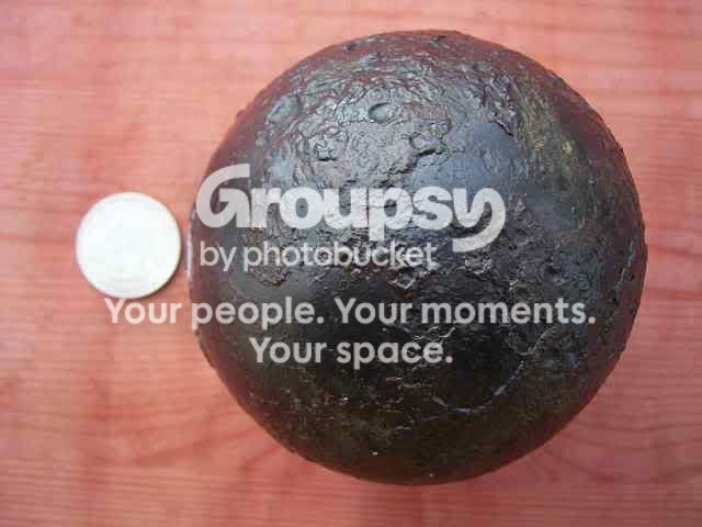

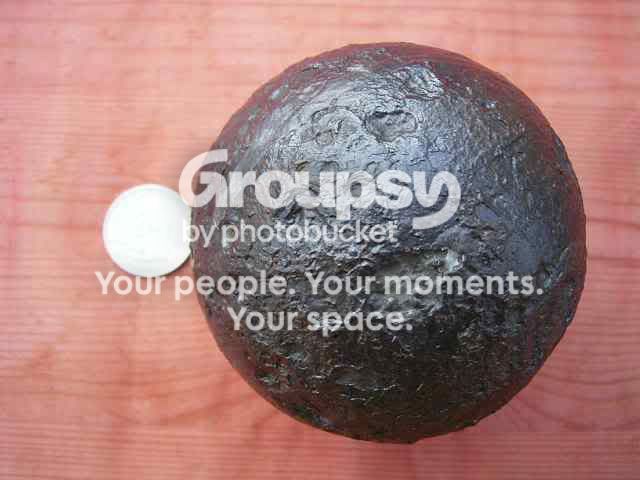

This cannon ball is from a battle fought in 1704, shot from the castle at a defensive position about 1000 meters from the castle. It is 3”/76mm and weighs 1779 grams after cleaning and conserving.
Another side of the cannon ball. It cleaned up nicely as well. HH if you can, LOL, Mike
