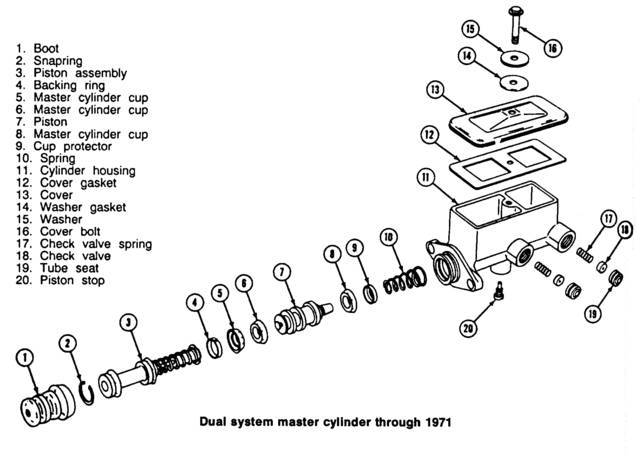

I feel like I should know what these are. I dug this brass cup today and it may not even be a cup, but it appears that it was designed to be a cup( ? ). A month ago at an antique auction, I won a small balance set that had the same "cup" inside. I am not sure if it is related to the balance set or not, but the fact of the matter is that I have no clue what they are or what they do. They have six small holes symetrically drilled in the "base" and are tapered to a rounded bottom inside the "cup." They measure 1.75" in height. The other mystery item is a chunky brass "disc" that has a hole machined into it, and two small non threaded guide stud holes. It measures 2.75" in diameter. Help folks, if you can, Thanks!

Think again. They are indeed master cylinder pistons.​
These are mid 60's. Yours are older.
Great ID Mick!
They are pistons from a car master cylinder. Number 3 in the pic.
