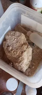

I crushed and milled about 10 pounds of ore samples from a new spot. I micro sluiced the milled ore I will finish the cleanup tomorrow maybe 3 grams or more from ten pounds of rock rich ground I'm thinking. Red sands Black sands and GOLD.
Have a picture of ore before u crushed it ?
The rock and a little sand before crushing no gold showing but the detector was making a little noise. My son and his friend found some good Gold in this pocket this rock was sitting on the bench waiting its turn. I heated it for ten minutes in the furnace makes it a lot easier to breakup before going in the jaw crusher
That’s an unusual ore for my area. Do you know how it’s described in miners terms? Looks chalky or like limestone.
@achanceforgold have you seen ore like this
Diorite and rotting granite with quartz stringers looked like red mud after crushing. I didn't rinse so not sure I wanted it dry
Interesting. Do you see exposed veins like that in that area? Was it in the tailings? I wonder if that was the ore OR did it just happen to also contain gold.
