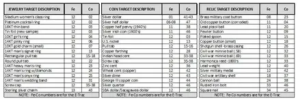

I've a target ID chart for the Etrac. The come out pretty darned close whether Etrac or CTS
Nickels will read about 12.13 every time, although V nickels or older nickels will read lower (12.10). This is when it is set up in the ferrous conductive. I still will dig a lot of pull tabs, but usually pull tab readings will bounce around (generally they read around 12.06-.09). Nickels will give a solid reading and sound that is hard to miss. I often will switch between an open screen pattern and a discrimination pattern and see if the reading is a stable reading. If it doesn't go down or bounce around I definitely will dig it.
ime, FBS is outstanding in distinguishing nickels from pulltabs. On my Safari 12 to 14 (almost always 14) is a nickel and if it hits 15 at all it is a pulltab. On my CTX, 12-15 is a pulltab and nickels fall as Pointman said. Call it magic, but FBS is good on this.
With the CTX you can go into combined mode and set a very narrow nickel "window" if you want. I've got mine set fairly wide: 12-10 to 12-15, but only dig targets that read 6" and deeper, which eliminates square tabs and newer Jeffersons. Unfortunately, beaver tails will read as a deep nickel but they will sound nice and clear, which is an indication of a smaller, shallower target.
That depends on the pulltab style. Every change to shape, weight, style and damage creates a change in the FE-CO response. If you are on a beach it might be possible to block out a specific tab, but in places like lawns and parks you are going to see every style. Even if you have a narrow window of nickle responses allowed, you will still get tabs come in at those numbers.
