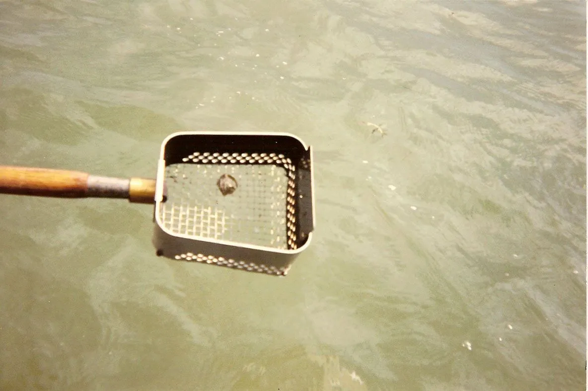

My CZ-20 works the same way. However I leave it in Autotune and just scoop. I think the signal response is larger and you can get a noise when coil is couple inches from the target to the sides. I also don't like to switch between modes as it wears out the switch I believe. I over slept and am out the door for some quality water time. 038.webpThis is the only type "scoop" I let the guys use on our swim areas because of fabric under the sand and this won't damage it. You pull it toward you and sand sifts through the 3/8" screen. You can dig deep with it by using it like a hoe. :thumbsup:
