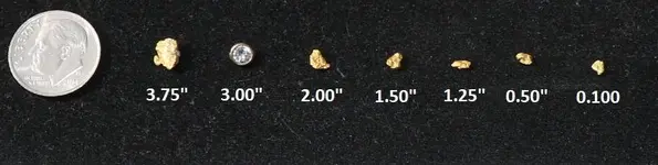

So if you're mainly a coin shooter/jewelry hunter, which HF coil do you get? Where I'm at on the west coast we don't have loads of history type sites to hunt so I've never really gotten bit by the relic bug. I have the 11" LF and want to complete my deus with another coil. As a beach hunter in the dry, would an HF coil be better than a LF coil? On my beaches it's all about finding the rings and chains other detectors have passed over which is why I'm looking at one of the HF coils.
80 kHz is going to be too much for the dry sand, the 9 inch round HF at 54 kHz already smacks gold this small, very small gold chains and gold stud earrings. At 80 kHz you are going to hit every little speck of foil.
