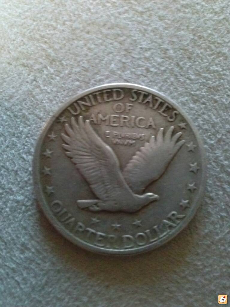

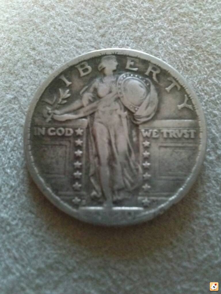

I to have DFX an I must say I live it I found some of my favourite treasure for instance this S.L.Q was,well read 8 1\2 down an it was right to the top of my digger
Sent from my LGMS769 using Tapatalk
Beautiful find!!
Sorry about spell check on my phone writes different words when I'm not payin attention lol "love"
Thanks shadowcat
