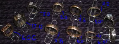

I have had my DFX for one year now and have found 19 gold rings and a 14k gold mariners cross. I have learned to dig almost everything. Anything from a 9 and up to 21. I know that means a lot of foil and pull tabs. Foil may not be foil and pull tabs may not be pull tabs. HH GFP
