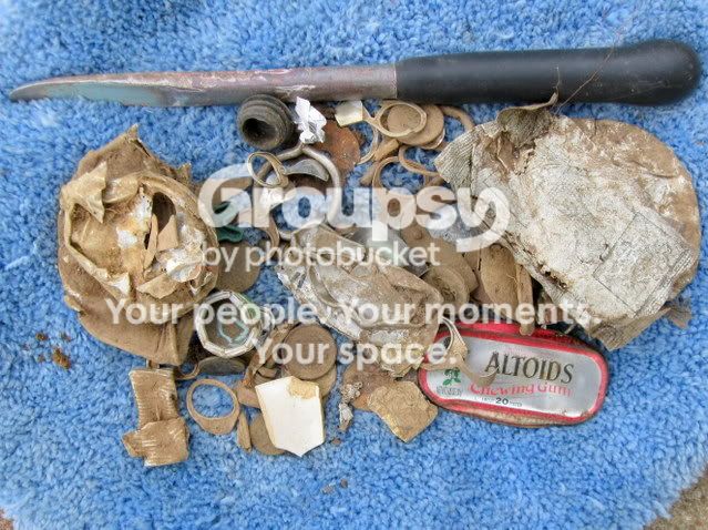

I'll let tha pic's do tha talkin,
That aluminum can was about 8" deep.
There was fill over the filds and the finds were deep, or on top.

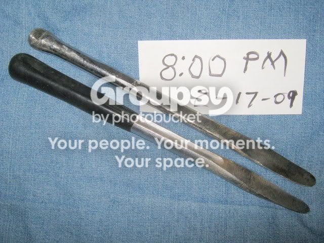

I made that one out of a Craftsman 15" long 1/2" drive
breaker bar.
The handle, I made into the blade of the digger.

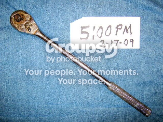

My second one is a 15" long 1/2" drive ratchet I got at
a pawn shop for $3.

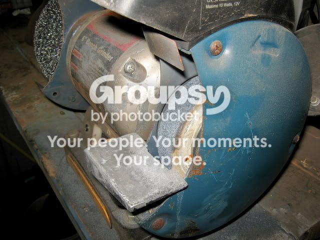

After 3 hours of grinding and keeping it cool by dunking
in a bucket of water before it got too hot and looses it's
temper.
Those two diggers are so hard, they wore my 6" grinding
wheel to a nub.

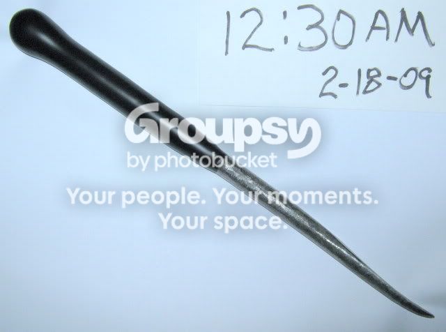

That roughed out my second digger.
Several coats of plastic coat from Lowes for $8.
It's a tough digger.
That's because it's tha Arkie Tabdog Digger.

This new digger I made has yet to mark a
target because of tha way it lends itself to
retrival.
The subtle shape makes it easy to scoop
dirt out of a small hole.
It is extremely tough.
I can stick the tip of my digger in a crack
in a wall and hang on it.
I am over 250 pounds.
I can throw it, tip first, on to concrete as
hard as I can throw it.
It will take it.
