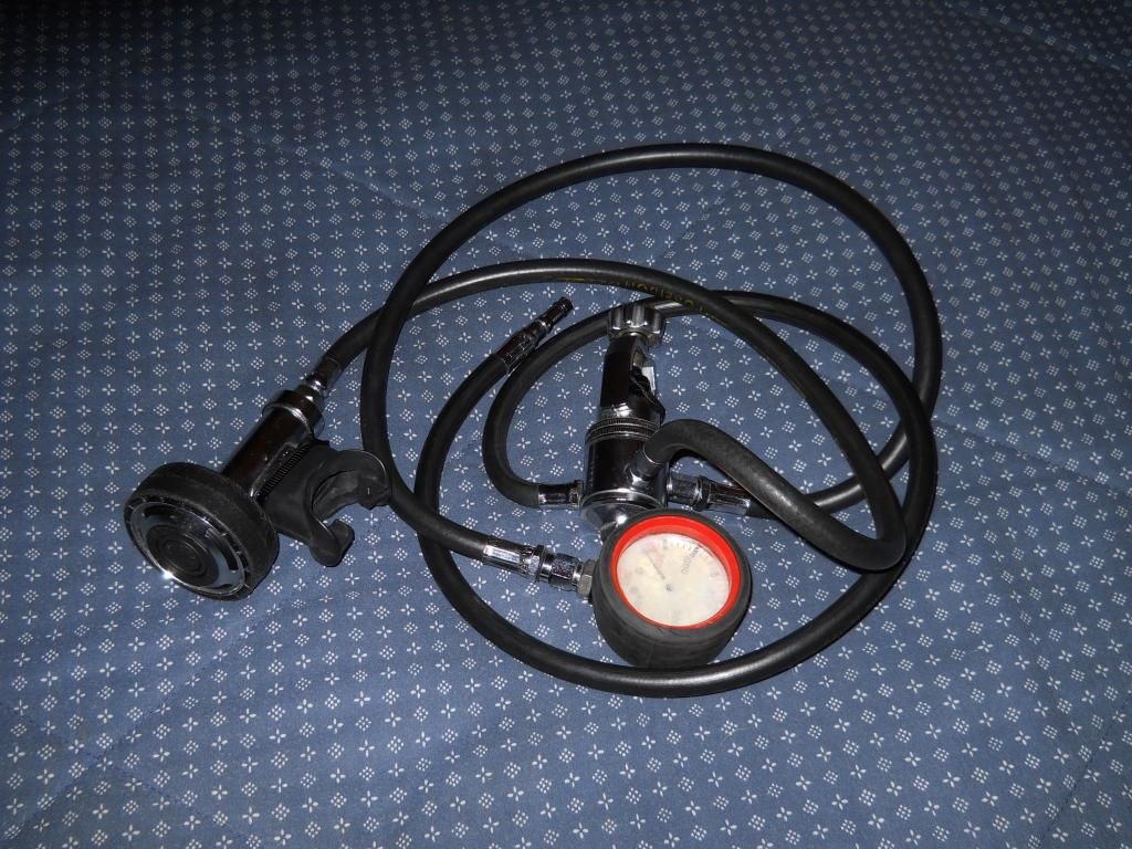

One of my first regs was a Dacor. (no not this one in pic)
