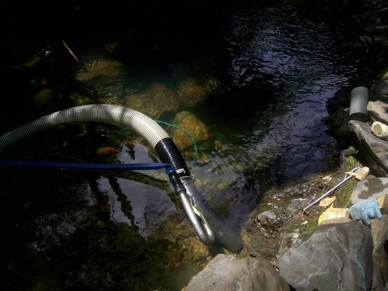

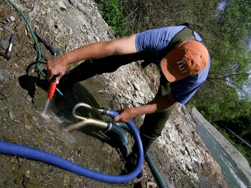

Hi Guys, I use a standard garden hose with pistol hand grip operation nozzle. Runs direct off the pump of my 4" dredge. Here is a pic of me using it above the water to flush bed rock schist but I also use it under water to blast material & flush bed rock into & ahead of the nozzle to loosen it up.

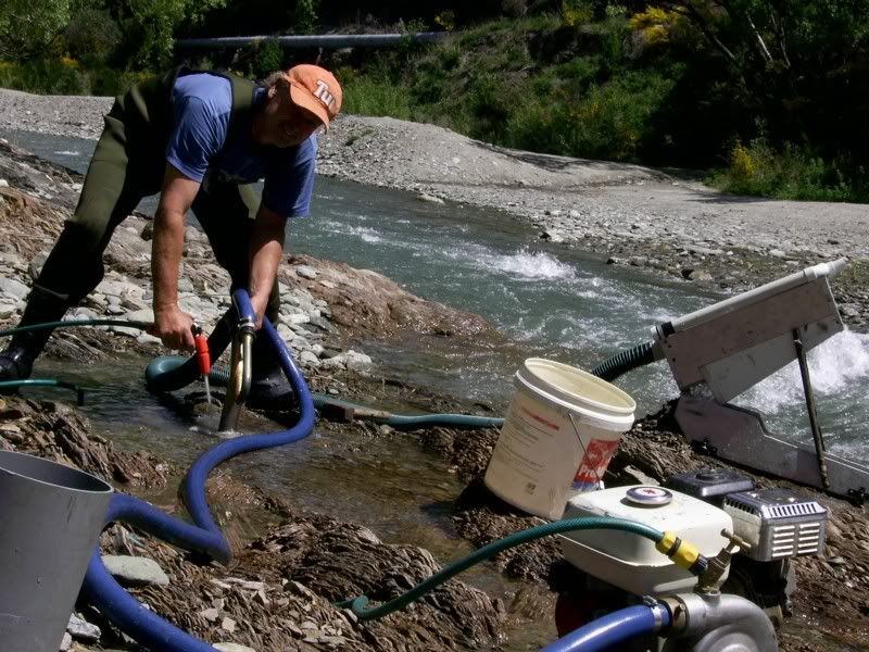

Here you will see the hose coming off the pump on the 4" dredge

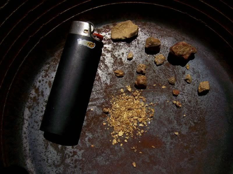

The hole I was working on
Gold found in this hole
