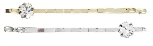

Ive finaly started to ignore double tap tones. Nine out of ten times they are a boby pin and the tenth time a penny. Do you guys do the same or do you dig the double taps.
Dig the bobby pins or you might miss these...
