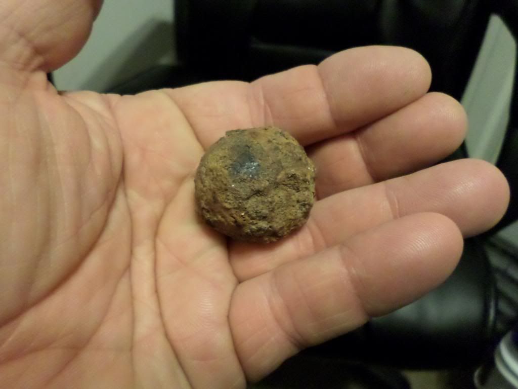

On a whim I tried cleaning some Iron canister shot with white vinegar instead of using electrolysis. Here is what it looked like when dug.
Next I used a cheap distilled white vinegar.
Let soak for 3 days in a coffee cup and lightly brushed it every day with a small wire brush like a tooth brush.
Final results with white distilled vinegar.

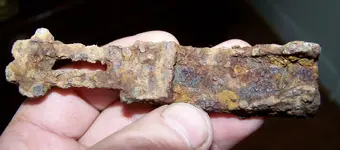

Electrolysis of an 1860 something Tenney English cast steel hatchet.
Before
After electrolysis reveled writing for an I.D.

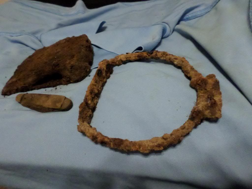

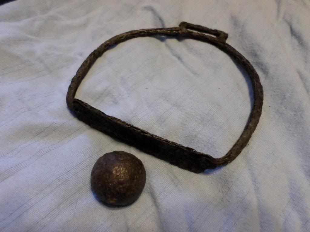

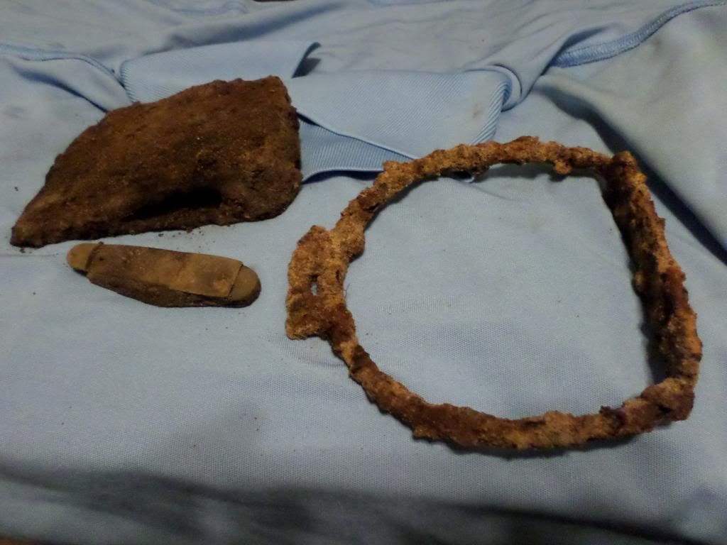

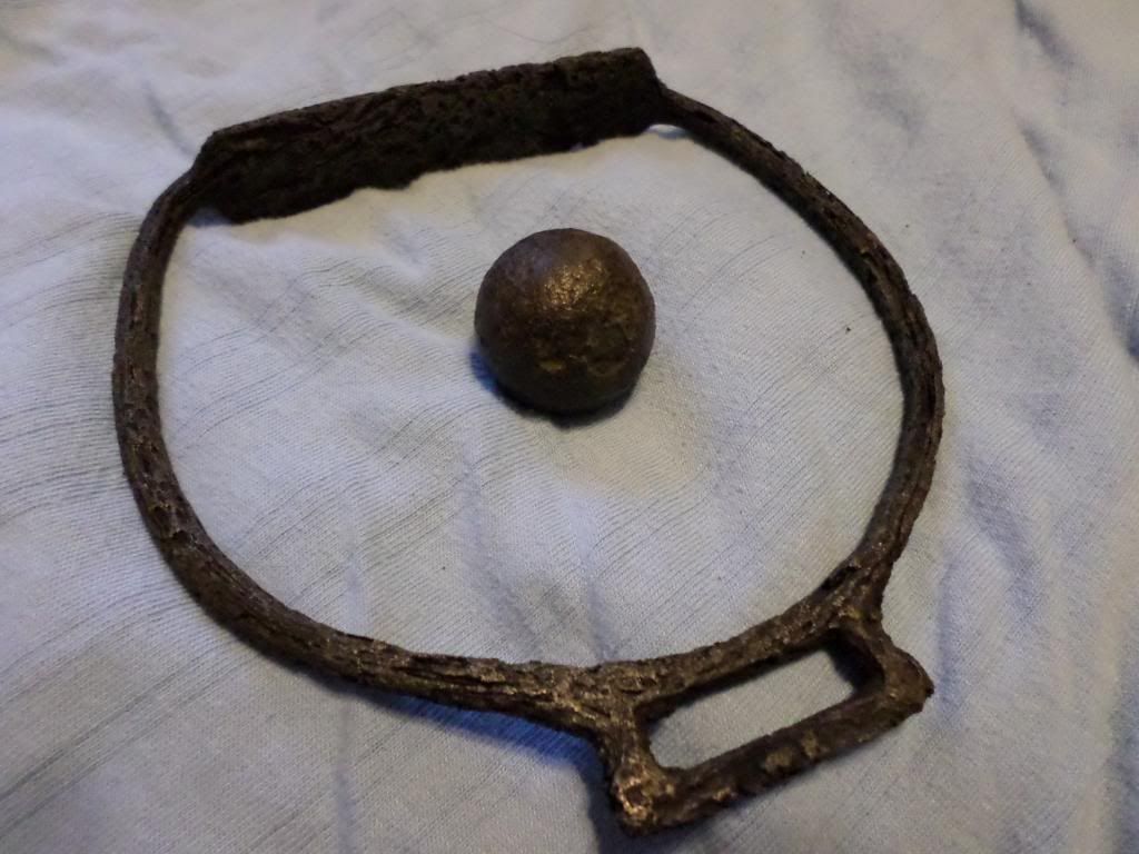

A few more days, wait until you see this. Its cleaning up sweet! There is still bubbles coming off it so I'm going to keep at it. I bought a 1.32 gallon (5 liters) at BJ's, I think it was less then 5 bucks.
Okay, here are the "before" pix.
And here are the "after" pix. These were in distilled white vinegar for seven days. I had much better results than my electrolysis set up and did it right here in my office.
