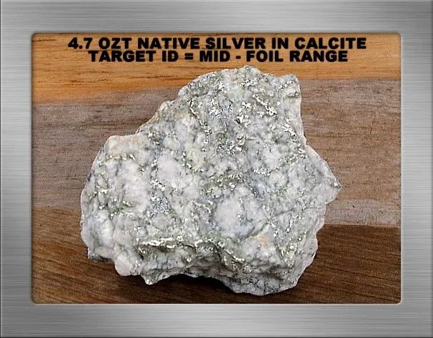

The small silver specimen depicted in the photo below exemplifies the quality and typical size of native silver nuggets and specimens commonly recovered in silver country at the present time. This particular piece was found using the F75 in the motion all-metal mode, near maximum sensitivity http://www.treasurenet.com/forums/c...5-metal-detector-revised-february-2011-a.html with a ground balance setting at GB86 and a typical Fe3O4 bar graph magnetic susceptibility readout at 0.3% EM. That’s a bit tougher ground than a ā€œmoderateā€ designation would indicate but certainly is nothing extreme.
The strength of ground magnetic susceptibility should have little or no impact to one’s target recovery technique because overburden should always be removed until a strong signal and reliable target ID readout can be obtained. If in any doubt at all then you must dig the target. Otherwise disregard target ID over any but shallow targets with good strong signals because in these soil minerals silver can read as iron. On the other hand compact iron and larger high conductive iron such as drill rods and implements can and usually do read as silver even at modest depths.

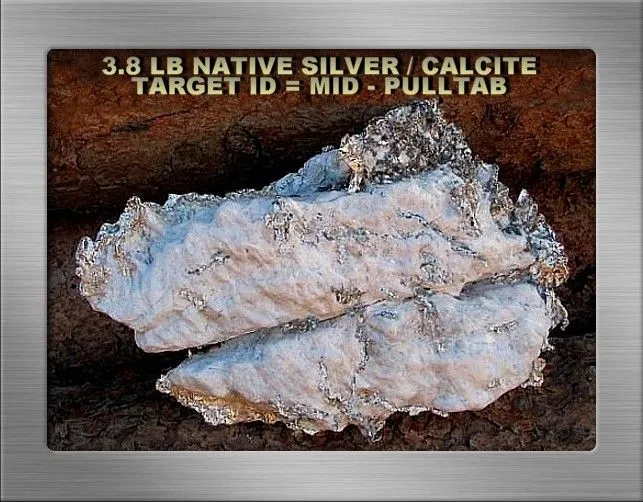

The specimen depicted below approaches the upper limit to what is described here as small silver when referring specifically to silver specimens rather than to silver nuggets. A three or four pound specimen is nothing unusual in the silverfields and is certainly nothing to be terribly excited about unless it’s an attractive ā€˜specimen quality’ piece.

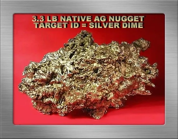

Let’s have a look at the handsome ā€œspecimen gradeā€ silver piece below, and then we’ll review some basic points to consider when selecting a ground-balancing PI unit for this application.
The primary reason for PI usage is to improve depth over VLF units in tough magnetic ground minerals. If one cannot achieve sufficient depth with a VLF unit to acquire deeper silver signals then all other VLF features or capabilities are of no consequence. The PI units I’ve selected also have a limited but very real ability to separate large and especially elongated iron from all silver ores and nuggets. The other main benefit of PI units is their ability to ignore most non-conductive iron mineralized hotrocks. However they do respond to conductive hotrocks such as the ever-present iron sulfide mineral pyrrhotite. Moreover, neither of these PI units can differentiate low conductive silver from low conductive ferrous trash. And that is precisely where the value of VLF target ID and discrimination features have an advantage over PI units in this area. At high trash sites PI operators can spend their days digging deep and shallow low conductive iron junk, and become frustrated with finding comparatively little or no silver.

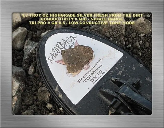

The photo below depicts what turned out to be a handsome ā€œnuggetyā€ silver specimen. It should have been field-cleaned prior to a photo… but nonetheless you can see the silver horns poking out beyond the dirt. Following the photo we’ll conclude this discussion with an illustrated side-by-side depth and sensitivity comparison of these units over freshly buried targets.
Operated at bare thresholds the TDI Pro is a noticeably deeperseeking and more sensitive unit. The Infinium’s depth / sens is improved by adjusting the threshold control up to 6ish or slightly more and adjusting headphone volume to preference. With this adjustment to Infinium…I see little or no difference between these units regarding depth / sensitivity over a variety of targets buried at variable depths in my testplot. There is some variability between different types and sizes of coils of course…we see that large coils tend to be deeperseeking on larger targets and less sensitive to shallower small stuff and vice-versa for small coils. Mono coils are deeperseeking compared to similar size DD coils in this moderately tough ground. Infinium’s mono coils are more likely to signal over high conductive large iron with an iron indicative lo-hi tone.

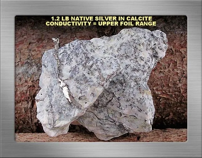

The photo below depicts another typical example of a small ā€œspecimen gradeā€ silver ore found with the F75 at a popular collecting site readily accessible by car. Despite the lack of clarity in the photo, those darker areas represent silver at or just below the surface. You might think the large silver vein would increase the target ID conductivity, but I doubt the EMF even sees most of it due to ā€œblockingā€ from adjacent ā€œparticulateā€ native silver structure.
When selecting a VLF searchcoil suitable for this application, the main factors to consider are iron trash abundance, the physical site conditions, and ground mineral magnetic susceptibility. We can’t change the search conditions so we must adapt our equipment and search technique to them. For example, you may plan to use a larger searchcoil to improve ground coverage and gain some additional detection depth. But nyet comrade, you find you’re unable to consistently keep the coil to its ground-balanced elevation over the ground due to surface irregularities, for example jumbled tailings. It results in distracting spurious ground signals. Unfortunately large coils see more ground mineral and react accordingly. You are faced with significant gain reductions to be able to continue searching with an unsuitably large coil. Alternately you may find that you are located at a high target density site where large coils are a poor choice. Signal evaluation is not possible when there are multiple targets under the coil. In either case a smaller searchcoil is warranted by site conditions that do not accommodate a large coil.
To reiterate, your best bet in most areas is to stick with the stock searchcoil and only make changes if the search conditions warrant or accommodate doing so. Ground coverage used to be a key strategy years ago when shallow quality silver was plentiful, but that is no longer the case at sites that have seen decades of collecting pressure. Electronic prospectors are well advised to take their time when searching… slow down and find more silver over the long haul. This strategy will enable you to hear and investigate very faint signals that are certain to net occasional multi-lb specimens at depth similar to the one below.

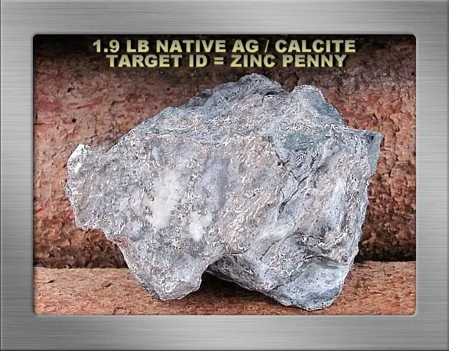

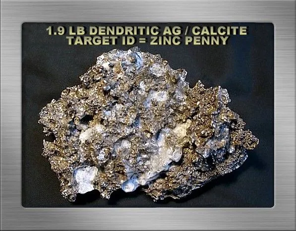

With that in mind, have a look at the high conductive silver specimen below, and then we’ll present some results from this past autumn using the GROUNDGRAB / FASTGRAB feature found on many modern prospecting-capable VLF units to assist with target signal evaluation.

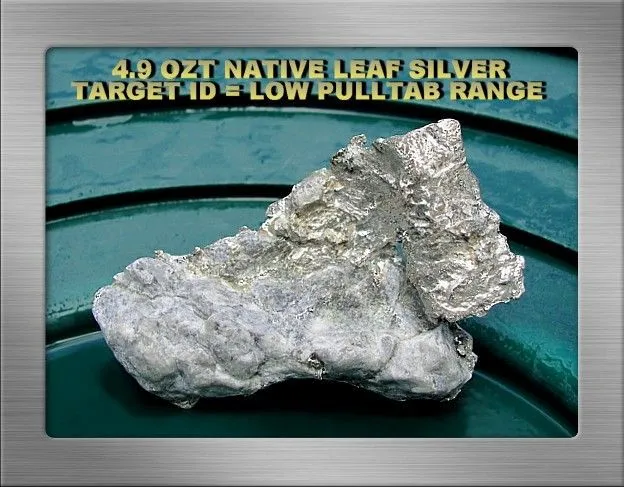

Last year’s article ā€œElectronic Prospecting in Silver Countryā€ introduced this subject with the comment that the GROUNDGRAB is accurate and convenient, and is an additional quick source of information when evaluating questionable signals. It makes searching hotrock areas properly ground-balanced in the all-metal motion mode more feasible because it takes only a moment to check out a suspect hotrock signal and then quickly re-balance to the ground and continue searching.
It was further noted that our positive diabase hotrocks read consistently in the upper iron range at target ID ā€œ14ā€ on the F75. But when ground-balanced using the GROUNDGRAB / FASTGRAB technique they lose their positive signal, their target ID disappears, and there is always a small reduction in the ground balance readout. Other positive non-conductive iron-mineralized hotrock types in this area react similarly but experience more variable GB reductions.
Some preliminary observations were also reported on variable silver ore responses, reduced GB readouts on ferrous junk, and niccolite… a nickel arsenide. We confirmed this year that as anticipated… the technique is not definitive for many targets encountered in the field. But we did learn more about what can be expected and readers may find the results interesting.
Keep in mind these results were obtained using an F75 operated in the motion all-metal mode. Note that the F75’s FASTGRAB feature does not permit ground-balancing below GB40. This feature prevents the unit from tracking completely into metals. The manual ground balance must be used to compensate for ground with GB values more conductive than a GB40 setting.
The FASTGRAB / GROUNDGRAB technique is subject to a few conditions. (a) It applies only to targets buried in undisturbed ground. Other than non-conductive hotrocks it does not provide meaningful test results if done over targets placed on the ground’s surface. (b) The target must be accurately pinpointed prior to a fastgrab exactly over the pinpointed target signal. The issue is that all too often the subsurface is littered with all kinds of metallic debris and mineralized rock both large and small. These can play havoc with any attempt to acquire unequivocal fastgrab results, as do iron mineralized ā€œhotspotsā€ remaining from rusted and disseminated bits of iron. (c) Do not try and ā€œbrute forceā€ the fastgrab by repeatedly pumping the coil over a target. It only takes three or four pumps to acquire accurate ground balance over clean ground, so we never exceed five pumps over a target. The concept is to permit the unit to make the decision about whether or not it will track into a target and by how much. (d) It’s not a condition but I do prefer the F75’s 10ā€ elliptical concentric to the stock 11ā€ DD coil for this work. It seems better able to retain the positive portion of a signal as you sweep a ā€œfastgrabbedā€ conductive ore or metal target that the DD tends to want to attenuate into more of a negative hotrock ā€œboingā€ or ā€œtwangyā€ type signal. It’s not a big deal and in some cases you hear little or no difference between coil types. But experience tells me the concentric coil is more consistent in preserving a positive signal over conductive targets.

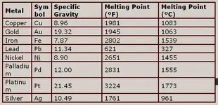

Next check the specific gravity… because we can check the chart below to see how your nuggets compare with other metals. Of course your nuggets may include one or more alloys. What is specific gravity? Specific gravity is the weight in grams of one cubic centimeter of a metal. By the way... one CC = one millilitre.
Determining the wet weight of a nugget is simply a displacement process. A nugget displaces an equal volume of water having a density of one gram per cubic centimeter. It weighs less in water by exactly as much water as it displaces. If it displaces 4 cc of water, it weighs 4 grams less because water weighs one gram per cc. So to determine specific gravity…
Specific Gravity = (weight of nugget in air) / (weight in air) - (weight in water) or in other words you divide the nugget air weight by the weight of the water displaced. It is easier with a small nugget to simply weigh it in water.
