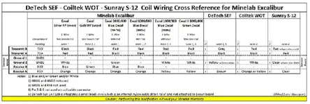

The connector also has 5 pins on it. I thought there were only 4 wires ?
blue decal excal 99-01 had 5 wires (I have one).
chuck.
excal SEF.webp This may be a little fuzzy but it is accurate. I have the older blue, 2001 and my SEF works fine wired according to this detail.
Thanks guys, I like the size of the coil just wish the wire was longer. It is possible that the item has been redesigned. Hopefully they will have a longer wired version so i wont have to splice it.
Found my copy, it is a little clearer and easier to read....Minelab%20Excal%20Coil%20Mod%20Matrix%20SEF%20WOT%20S-12%20drs%20v30May11.webp

"If" you can see it (wires blocking mine) there is a serial number on the mother board - you should be able to see through the clear portion of the housing (might have to take the pod off the shaft).
