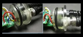

I've been thru many setups but the best I've done is the coil change endcap, after a few different fails I found a really good connector which I could use. The 3M..SS 4 pin. I use to make the kits but no longer.
Never had a Issues and going on 3 1/2 years now of use, 2 of my Excalibur use these and the other 2 are hard wired. And I only hunt in the salt water...
