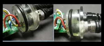

That is a oldie Sword and severed you very well! I never had any luck with inline connectors specially the Bulgins. But some say they have, one is Clive..you may want to check with him. I think the numbers you posted could be the bulgins... Since I went with the 3m and in the endcap they have been the ticket for the last few years, but I'm still up in the air if they are costing me a inch or so. Seems fine but more testing is needed. These are what I use now for the endcaps...but you could try them inline. I also added a O ring to them for if you tighten them up to much it will snap off the little ridge, the oring prevents this...

Notice o ring added, this unit has about two years of hunting in saltwater. (Maybe 400 hours a year?) I tore it apart about month ago and redid all of the knob shaft O-rings, everything else looked good. I do keep my fittings silicone greased very well.
Also very important, always fill the fitting with epoxy just incase it should leak, and this also prevents twisting of the wires inside.
