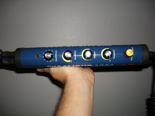

???????????? my Excal ll has numbers on Disc and sensitivity.dont need a clock????
The Excal II comes with numbers on it but backwards from what we owners of the original Excal always imagined when we talked about adjusting the sentivity controls.... Auto is 10, where we would have called it 7 o'clock, your 6 is what we called 12' o'clock
In answer to your question again, I have ran mine at your #4 setting and seen no loss of depth, still dug targets over 12 inches deep. I pay no attention to what the sensitivity is set at, I adjust mine till it is stable, then kick it up just a hair hotter. Usually this is somewhere between your 8 to number 4 settings...
Hope this helps some to clear up what we were talking about...
Excalibur II Controls
Excalibur Controls
