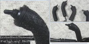

I have 2 excals with large coils, both with the pinpoint mod on the handle so i can switch between all metal and desc with out reaching behind my arm to switch between all metal and desc, I can just hit the switch to change the mode with out moving my hand from the coil.... I like the mods and for me pinpoint is deeper. I also have the older versions. The Excal II is deeper out of the box than the ones it replaced, but not by much, maybe 2 inches, since I put a SEF 12"x15" butterfly coil on one and the 15" WOT on the other both of mine go deeper than the 8 or 10 inch... I have pulled plenty of targets 15-16 inches deep with the,,,

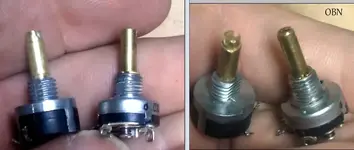

Of resent I have also add a new tool to the Excalibur...A smoother adjustment on the threshold on/off of the Excalibur, these are 50 Ohm, and allow a smooth and lower threshold on the Excalibur then before, still testing but being able to adjust the threshold lower, adjust the target volume to full, and with the Skullies being able to turn the volume down on the HP, equals deep targets.

PP or Disc? Depends on my mood and the conditions. For me, PP = intense hunting, really have to pay attention to every little change up, be in the right frame of mind for it. If I'm water hunting and there's a lot of current and wave action or the bottom is really uneven just too many distractions/disruptions since I'm going to be unstable on foot myself, so I hunt in disc mode. Same if I just want to cover as much beach as possible or when I'm not in that slower mood. But when the conditions and my mood are right I'll PP hunt quite a bit. I will say this, since adding the remote PP I do use PP a lot more often then I use to, regardless what mood I'm in as it has become a very convenient tool to access.
