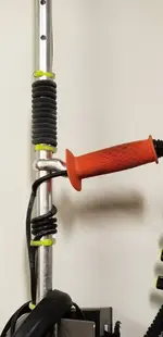

Mount the controls, use tie wrap inside air hose to secure the cable to the shaft just behind the controls, then let the coil hand free and start spining the shaft so the cable winds around the shaft like a fishing reel, letting the coil hang allows it to spin and keep the kinks out of the cable, once you have rolled up enough cable use another cable tie inside air hose to secure the cable to the shaft again.

Sorry, the air hose is the small hose used on aquarium air pump, you don't want to put tie wraps directly on the cable, if they are tight over time they cut into the insulation. You cut the hose so it wraps around shaft and cable but leave about 3/8" gap so it can be tighten, make sure the hose covers the cable and then tighten it.

O.K., got it.........you thread the tie wrap thru the aquarium air hose to act as a cushion when wrapping around cable and tightening to shaft. EXCELLENT !!
