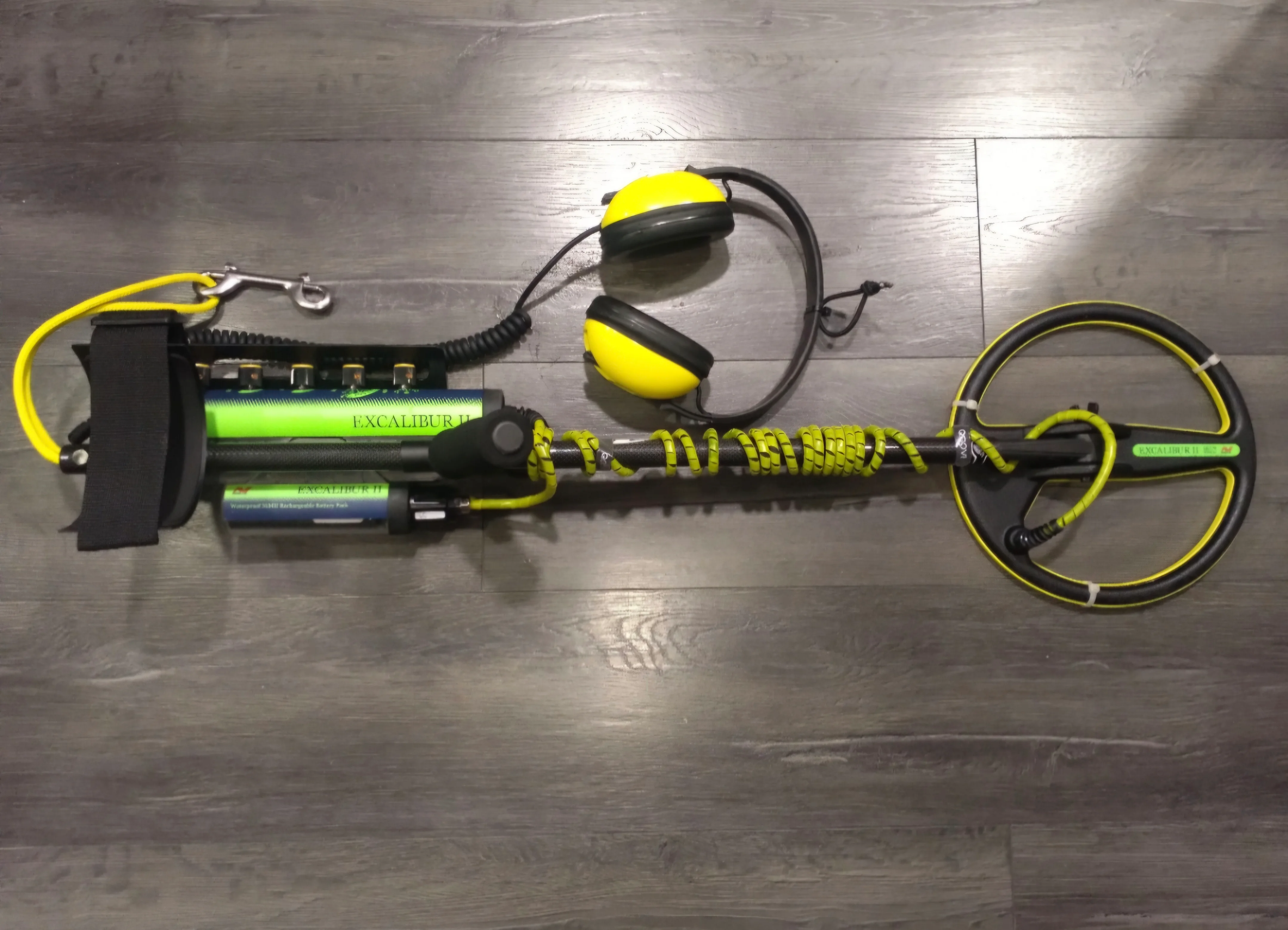

  1. How do you attach the control cylinder, rechargeable battery pod and control panel?
  2. See the attached pic. If this is all I need, how would you attach the end (red arrow) to the coil?

Did your Excalibur come with the short dive shaft? If not, you'll need the dive shaft that's pictured in the Amazon link that you posted. The control and battery pods attach to the upper assembly below your arm. They attach just like they do on a stock shaft except the pods are turned 90 degrees. Look for pictures online of the setup put together. There's probably thousands of them.

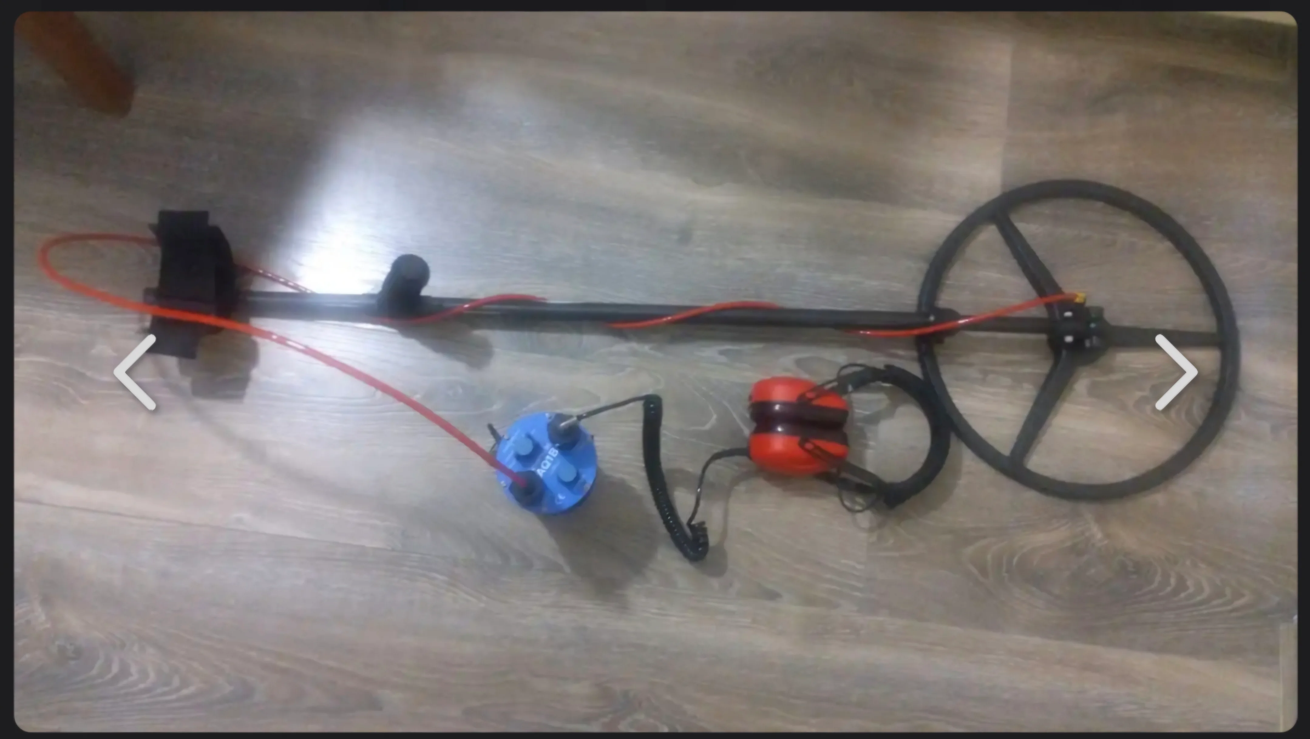

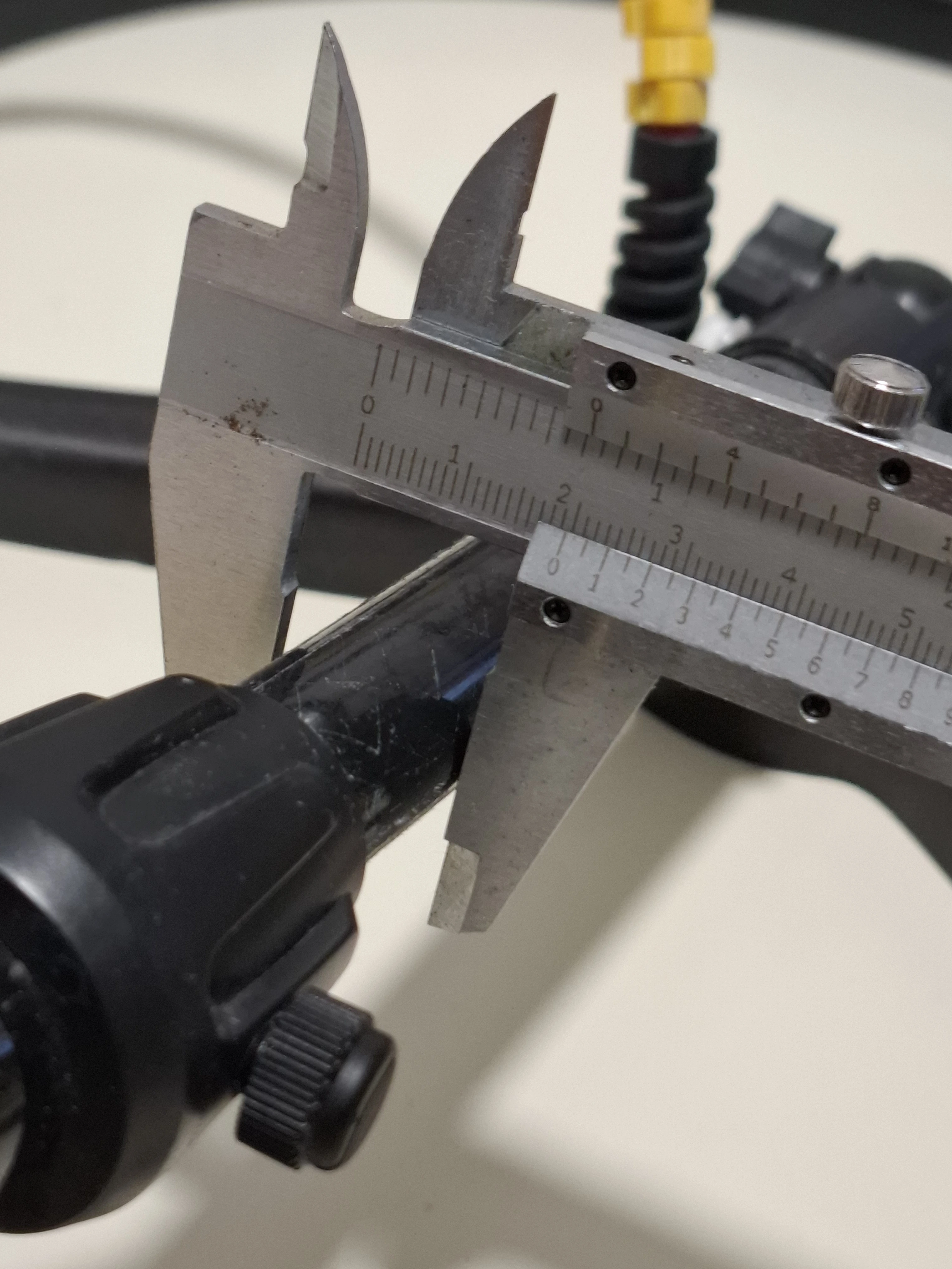

My shaft is complete, without a front rod. It is intended only for underwater work with autonomous equipment (SCUBA). I bought it on Ebay a few years ago. This is an incredible shaft, created by people who understand hydrodynamics. As I said, it does not tire the hand, because the battery and control module are located horizontally from each other, and not vertically, as in the original shaft. I went to the site and to my surprise I can not find it.

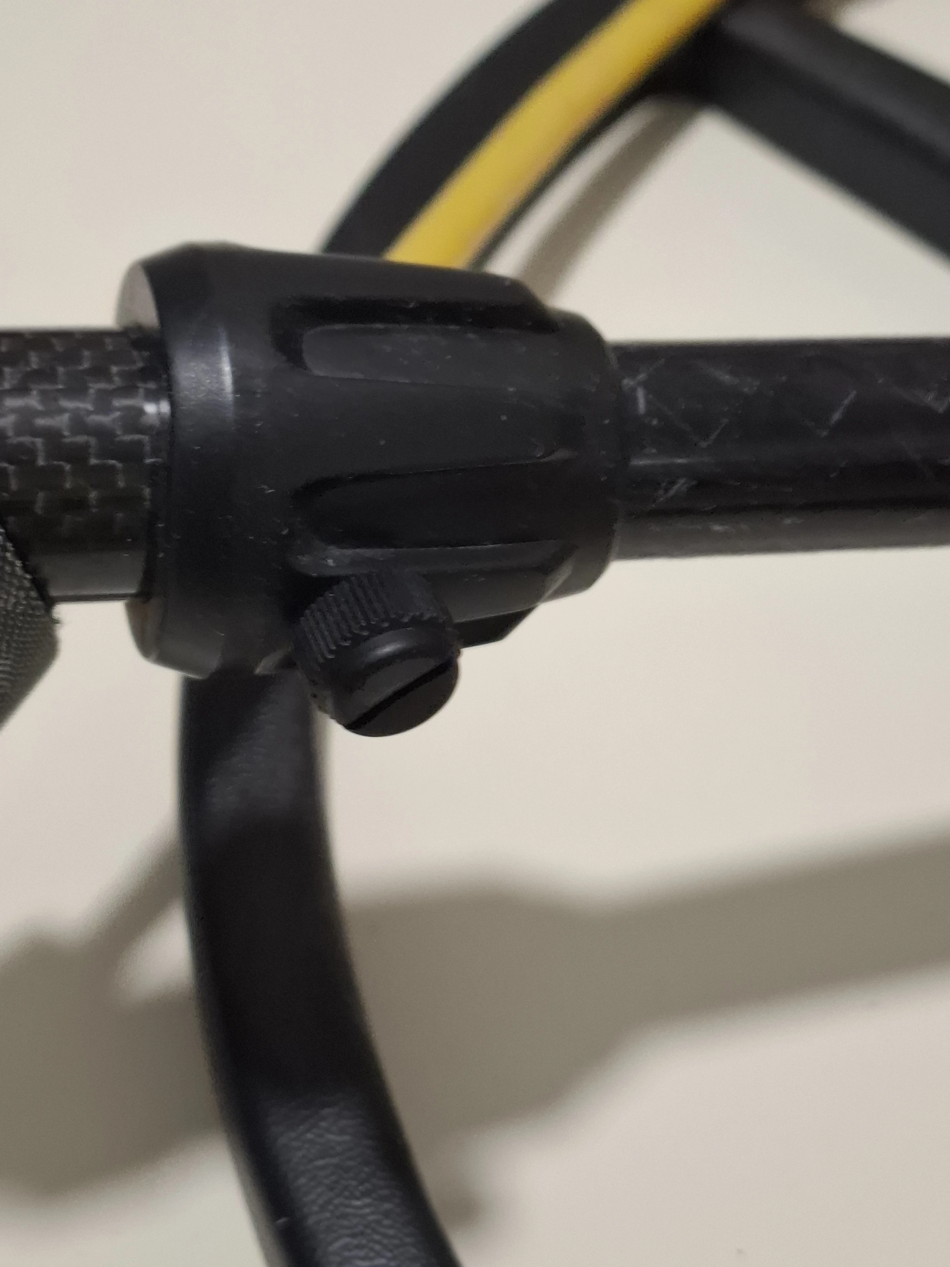

Yes, I have that shaft too. The back part is exactly the Anderson one you show, and the front part is the long shaft of Excalibur.
The shaft is longer than yours in the picture, but the connection mechanism is the same.

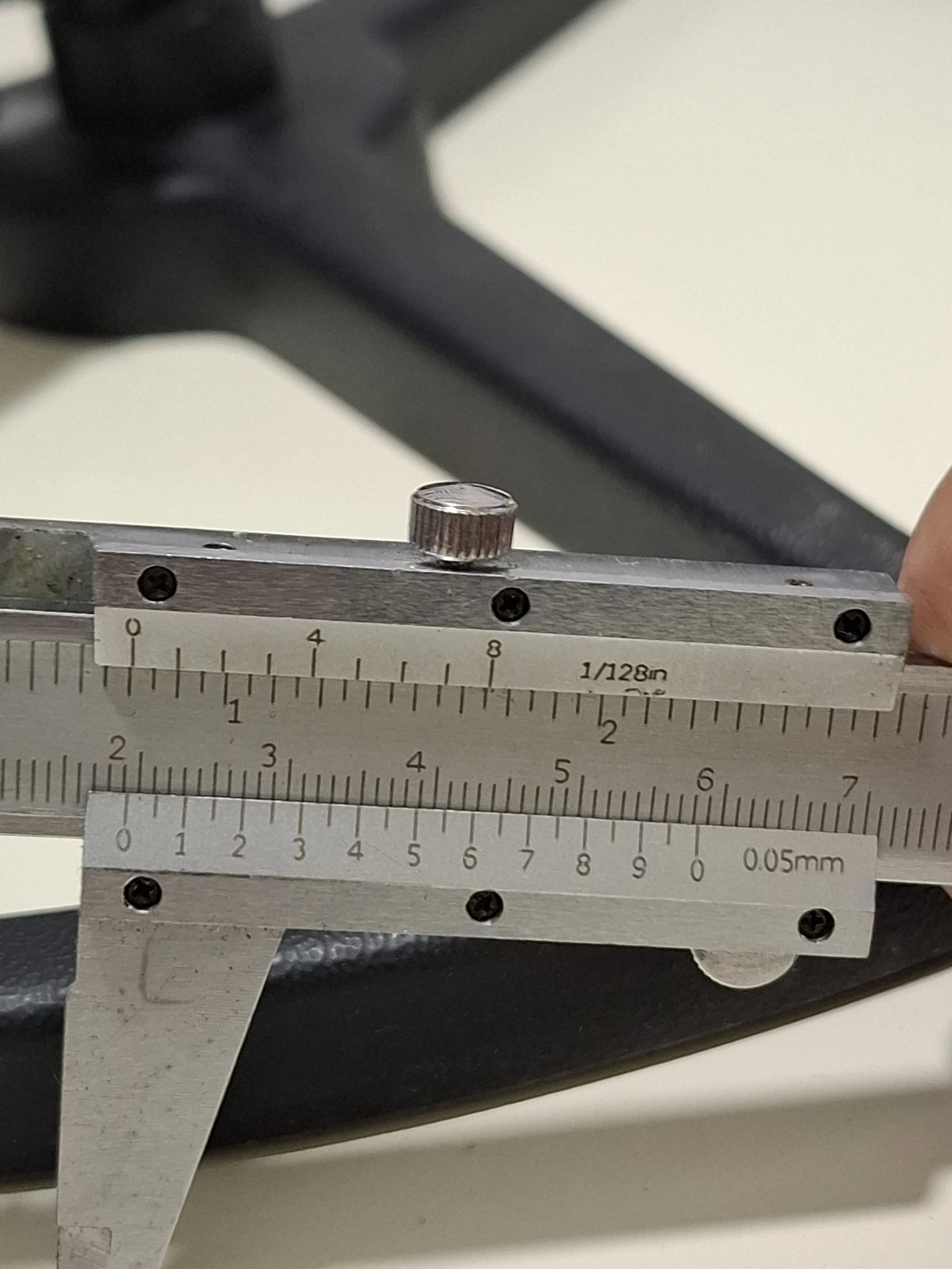

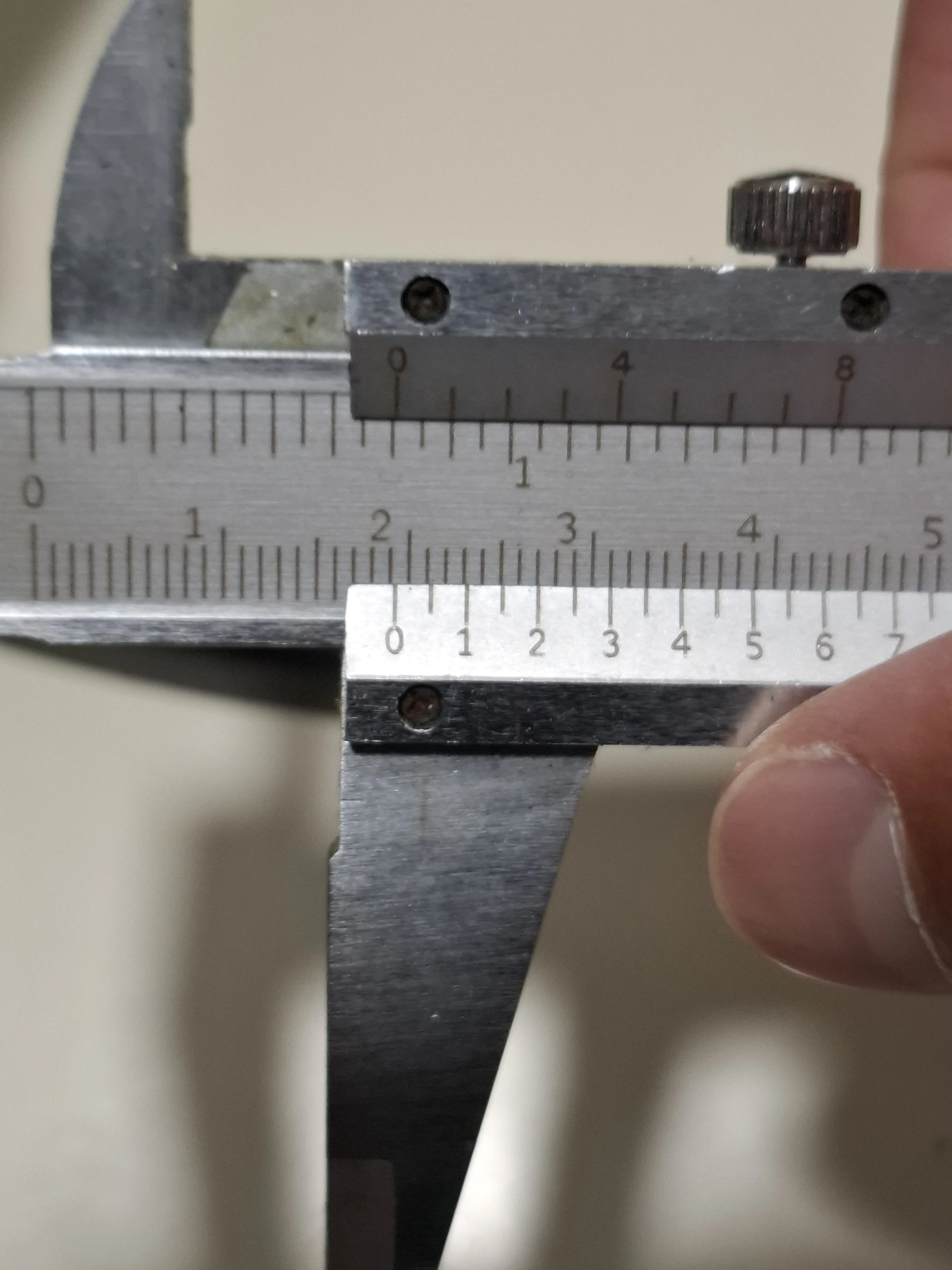

I took some pictures of the standard grip on the Anderson carbon shaft and the front shaft from the Excalibur 2. As you can see, everything fits perfectly.
