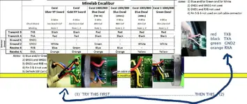

Does the Excalibur II 800 and Excalibur 1000 use the same signal processing algorithms or is there a difference? Same PCB/main boards.
Does the factory tune the Excalibur II 800 to be optimized with the hardwired 8" search coil to detect smaller size objects. No, not like the Blisstool where every coil is tuned for that machine, Each excalibur part meets factory standards and all are within Factory Tolerances. No scopes used to fine tune.
Does the factory tune the Excalibur II 1000 to be optimized with the hardwired 10 " search coil to detect larger size objects...Same as above...
Things have changed over the years, but still the same brains...BBS technology
Thanx for the answer(s): Chuck, wallhanger, OBN - especially for the detailed technical information on the Excalibur II and tuning of the Blisstool.
