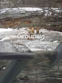

I took a short hunt this morning. but at 16 degrees 2hrs was plenty long enough.
I hunted a small area that I had pounded over and again with my ATP/NEL.
The Deus really shined. I'm starting to really understand the Deus and the programs.
I still need to get the tones down when it comes to square nails. but other than that I'm very pleased.
Every target was deep and just gave a whisper even with the audio responce set at 5. once the plug was out
the tones would get strong and there was not much guessing what was in the hole.
Every target was deep and just gave a whisper even with the reactivity set at 5. once the plug was out

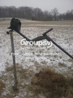

the ground was as soft as spring time. the only problem was the wet soil freezing up on the tip of my pin pointer.
as you can see in the background I was in a good sized field. I have been all over this field in the last 3 months.
only one spot has gave up relics. a gentle hillside looking over a small spring fed creek. I have dug close to 80 mini balls (at least 70 have been confederate) ,8 or 10
buttons and other relics including small buckles and a scabbard tip. all in a area 50'x70'.
