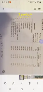

I had ore samples tested from seven different veins on one property. The first results from a small assay lab in May's Landing, NJ provided results that showed the veins to range from a low of 0.109 gold oz/T (0.81 silver oz/T) to a high of 0.328 gold oz/T (0.167 silver oz/T). I then sent the same seven samples to a large lab in Sparks Nevada that does testing for the largest mines in the US. This lab showed "non detect" for both gold and silver (results were <0.01 Au ppm and <0.1 Ag ppm). Both labs performed a fire assay using 29.16 grams of ore and both tested the same seven ore sample materials. The ore samples were from two historic quartz lode mines and from an unmined greenstone (non asbestos I had a test done) serpentinite vein system discovered during logging. With such widely varying results do I now get a 3rd test done and if so, from whom? Could the first assay be a false high positive?

Seems odd the seven samples from seven different areas sent back east all have trace amounts of precious metals. But same samples sent to a well-known lab in Nevada precious metals were absent

Definitely time for a third (and possibly fourth) split of that sample to be sent off for a check assay. How large are the initial samples and what kind of prep/splitting was done before shipment?

The BLM assay report shows a very wide range of assay results for the same sample. Unless you know how many ounces per ton you have before getting an assay done it's hard to tell if you are getting good information back. Guess I can see if any of the labs that tested close to the true BLM baseline are still in operation and have them run a third test for me.
...make up a known blank /sterile sample like the BLM did and send that along with your other samples for assay...and hope a report of anything other then "non detectable" doesn't comes back for that particular sample, a N.D. baseline for accuracy has at least some slight merit...
I have had good luck with Ray Grimmer labs. I think they did a good roasting job on my ore before they fired it from all other assays i have had done on the same ore.
If you're not in a rush on the results i would take that "black seam" sample .32 opt and send it to a 3rd assayer. The first assayer said they ran that twice. If the numbers on that one check with the 3rd assayer then I would go with the large assumption that the first set of assays was correct. If not then sadly it's time to rerun the whole batch. I have run some samples of known values by Reed Laboratories and they came up identical to the known values with the exception that they parted the silver and gold which I didn't do. They also do spectometry if you think there is other metals in your samples. Expensive but I have been pleased with the results. I'd put my gold on that first assay being correct.
