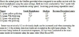

Here's a before and after air test on the Skullies (click to enlarge image)
Those depth difference arent to far off from what mine were. How did you find the sensitivity to small targets? First few times it gives you the feeling you arent getting any depth.... it just hears them that good. Really should be an advantage for you and that small coil on those chains you been finding. Wait till you get out there on a windy noisy day..... huge difference when you take them off.

Bigscoop, I love that chart. Something I have wanted to do with the skullies....thank you....:icon_thumright:
One of the oldtimers over on the other forum posted this years ago, and since reading I have worked to find those missed unheards...first with Doc's amp, and now Skullies....

The chart, when I say "good/strong" repeatable tones, I have to include even the faints with the skullies because there really isn't a faint anymore. They're there, it's just they are much sharper and easier to hear now. I've always said these machines are hunting a lot deeper then we realize and that they just lack the means to tell what they're finding down there. If I can locate a beer can at 2 feet then those send signals are indeed getting there, it's just the returns are too weak to on the smaller items to tell us about them.
