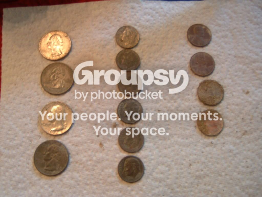

Anyways, After trying to pinpoint the detector, I switched it back to detect mode and decided to go to the beach on the other side of the park. I walked down the path and 5 minutes later ended up at the beach. There was no one in sight and it was a fairly good sized beach. I started on the left side of the beach and got quarter after quarter signal until i had 4 of them. Then I went into the middle and the right and found 6 dimes. I am assuming that the Minelab Explorer SE is hungry for mostly Quarters and Dimes. While I was going back and forth across the beach, I got 4 pennies. One of the finds was a 1964 penny. Theres got to be silver somewhere in this park! Also one of the quarters was 1967 which is three years away from silver! :'(

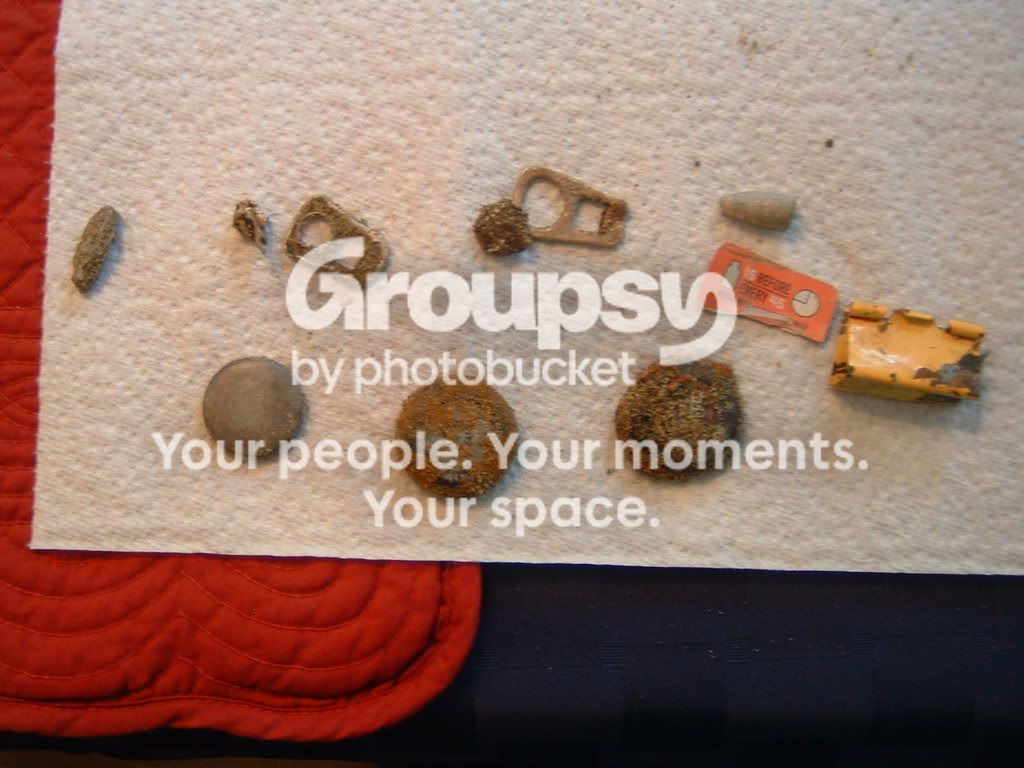

Anyway here is my finds:
Nice finds! Practice. The pinpointing can be tough with the SE. When I started using it, I figured out fast that you need a probe with this machine. Don't get discouraged, it is a GREAT detector and you will pull some super deep coin with it.
Great finds for the first time out. On pinpointing, sometime the edge of the detector picks up the coin first and you think you have it centered but actually the coins is on the outer edge of the coil. When you swing over the target and you get three beeps the center beep is where the target is. I hope this helps.
