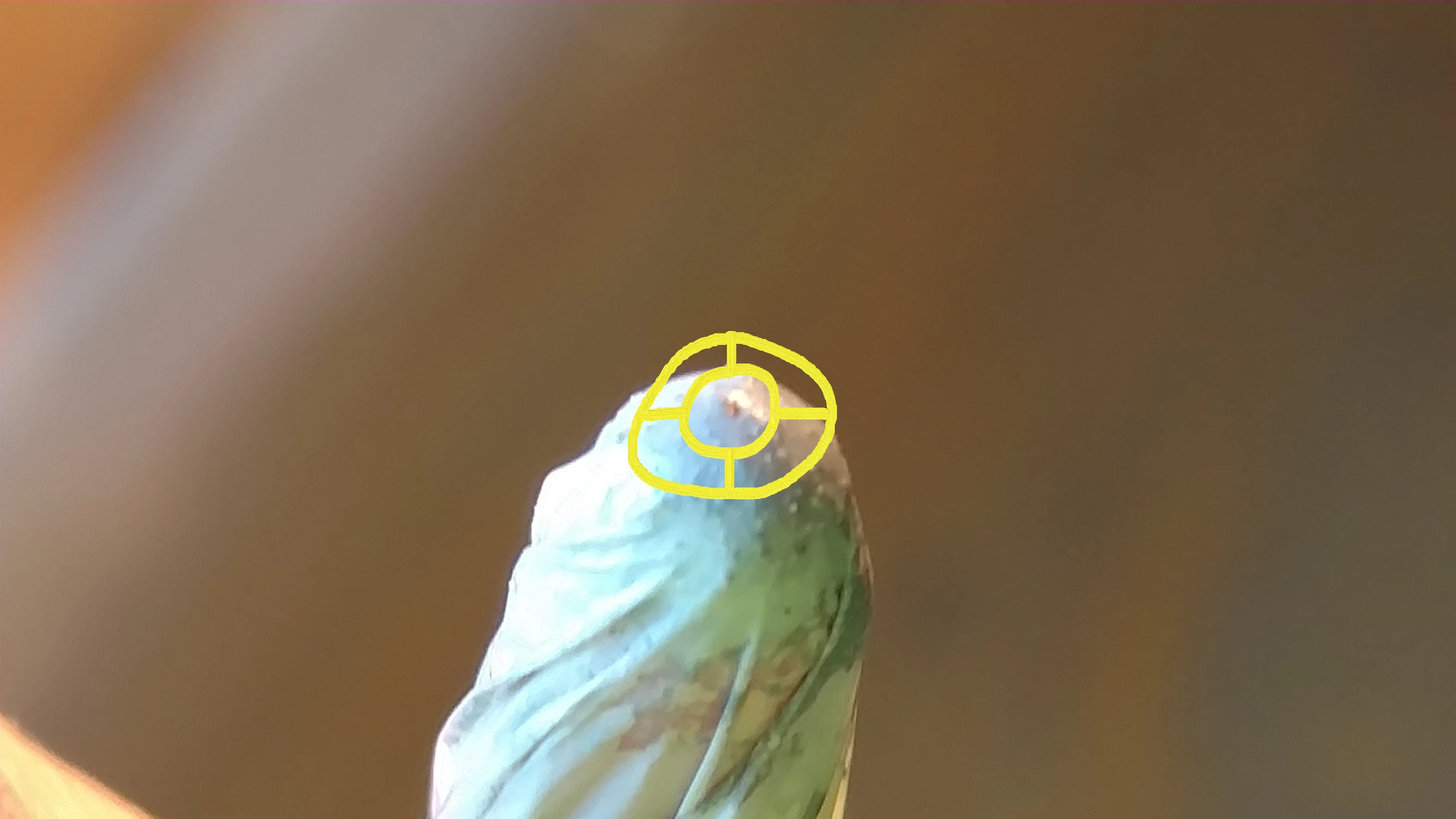

piece of gold on tip.webp this is a single "piece" of gold on the tip of my homemade extraction tool.
the tool itself, if an odd thing, i have always been told and read that gold cannot be picked up with a magnet. my tool may be an exception to that rule, or maybe not. it works, that's all i know.
this is my gold extraction tool. yup its a syringe we got from the vet, when we had to give a kitten that we no longer have medicine :sad10: anyway, it was the only available thing i could find that was small enough to use, i superglued a steel BB to the tip of the syringe, then i took a piece from a white plastic bag, in the center of the piece from the bag i put cleaned black sand (not a lot) then i put the BB tip into the black sand and wrapped it with one of my wife's hair ties, this give the tip of the tool a center point for picking up gold, from the pic above this post you can see that it does grab small single pieces of gold, it does not work on bigger pieces of gold (i tried it already) but it does work to extract single pieces from dry material, it did not work on fine gold in water.
