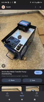

Sorry about that. What I have is a small Miller table with a sump pump I believe it's an 1100 GPM. I have a ball valve on the line now but I don't want to use a ball valve instead I want to be able to dial down the flow when using the Miller table. A buddy of mine was able to get one made for him and the guy put it in a old military ammo box. The reason for the battery is so that you can run the pump and the Miller table when you're out at the claim and not have to lug around a car battery with you. It will only be used when I'm using the Miller table so it will be in small time frames so a 5 ah battery will do me just fine

Here's a picture just to give you a general idea what I'm looking for something along the line of the photo.

Can't see the internals BUT it looks like he made a nice looking device ! I'd like to see a schematic on how it works or at least a picture of the internals ! BUT it is his device and may want to keep it to himself . I understand that !
use a rheostat and build your own, if you are going to carry that ammo box with you then you will not need the drill battery.Photos of the inside of my battery pack, I have terminals including a 12v plug on the outside. A rheostat can be added

What brand of battery pack? Those voltage converters and motor controllers are dirt simple to wire up. To do it right, and durable takes a bit more though.
I use a pulse width modulator on one of my smaller highbankers if the situation dictates that I have to use an oversized pump. It conserves battery life vs. a valve, if that's a concern. May not matter too much with an 1100 though. You can use others but make sure the amperage rating is higher than what your pump draws. I burnt up my first one, which was underrated. Oops. This one serves me well when I need it...
https://www.amazon.com/Yosoo-Motor-Control-Controller-10-50V/dp/B01B604UQ2/?tag=treasurenet01-20
