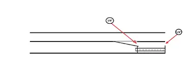

Double click the diagram to enlarge it.
On mine the output opening is 1/8" taller than the input. A sleight hedge due to sluice almost always being run on a down slope.
Distance from output lip of trap to bottom of top cover is 5/8"
The input opening is 3/4".
Not sure about the use of 1/4" screen across the top of the trap.
I've never tried it so you are on your own. If it doesn't work it would be easy to change out.
