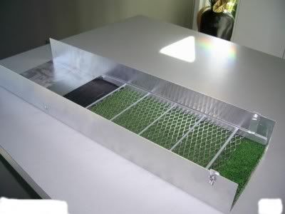

Hi there, Here are some pics of a little sluice I made for back packing into remote places. 36" long X 9" wide 3" high. Works fine just like that but I have made another section the same length that will fit inside this so takes up no more space in the pack, but I can slide it out, bolt it in place & I can almost double the length of the box.

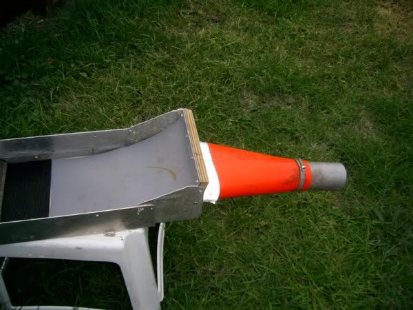

Here we have the flare attached with the dampner folded up & over the flare so you can see into it. The two bolts sticking up are for holding the classifyer screen that goes down to just before the first riffle.
Bit of a side view with the dampner down in place.
With hose & nozzle attached

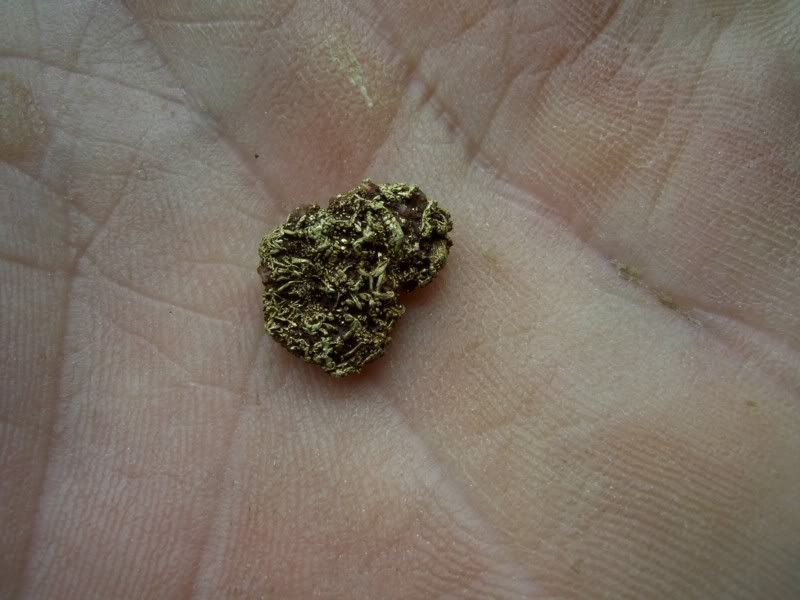

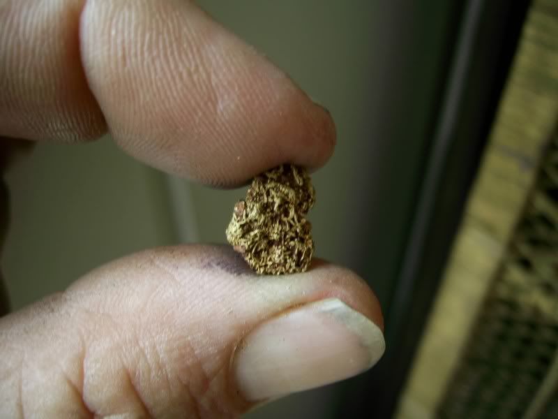

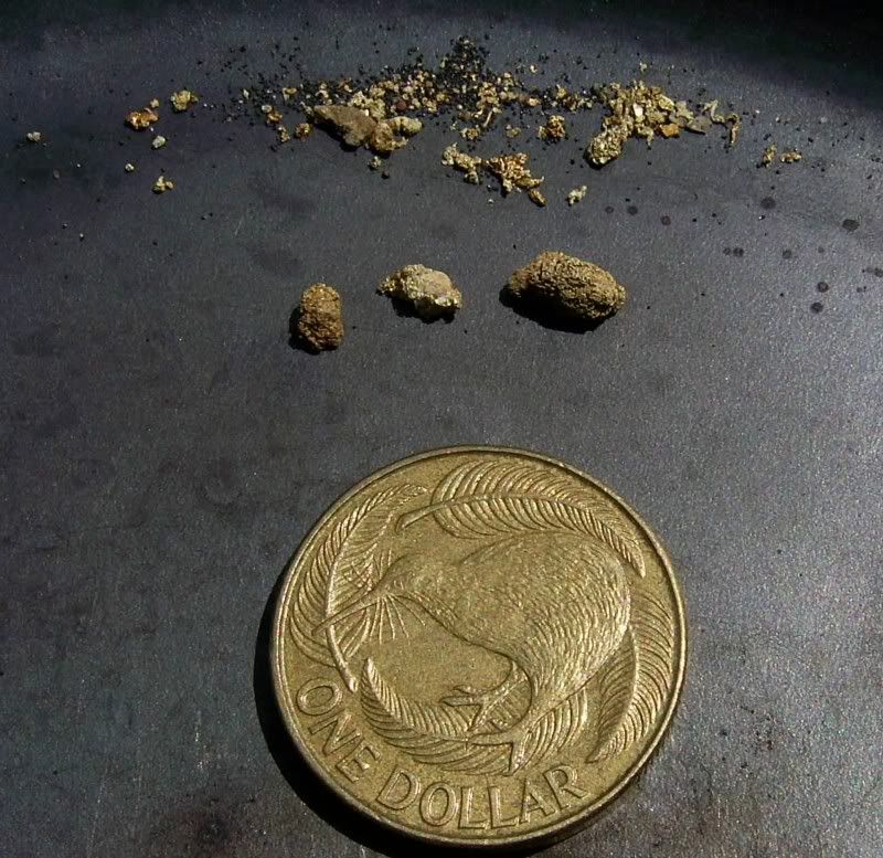

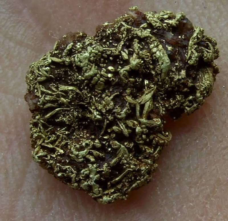

And gold found
