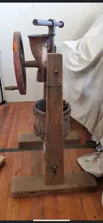

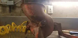

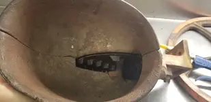

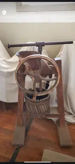

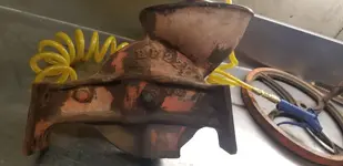

I think this is a fruit press but cant find any information on it. Its different from most as the grinder and press are combined. Only markings is HF and numbers based on the part. Any help would be great. I want to restore it and hopefully make apple cider.

What you have is a Hartman cider mill from 1920 or so. The price for 1920 was $13.75. It was a unique setup and worked very well.
I remember a slightly new version of this press when I was young...mid 70s...and the press was old then. At a site of an old apple orchard in south west Oregon.
Meant to say newer version
Kudos to Tony for the quick I.D. on your apple cider press. :notworthy:
That piece would restore nicely if you ever choose to go that route.
But I doubt very much that your wife would appreciate it being displayed in your living room. :laughing7:
Dave
Wow what great info and response. Much thanks. I want to use it as intended. Thoughts on restoration?
I know someone who still uses one just like it. They built stuff to last back then.
Awesome I'd they did build stuff better back then
I would clean it gently. Just remove any dirt or grease. Leave the rust and old paint. Paint the exterior(wood and metal) with a mixture of 3 parts mineral spirts and 1 part linseed oil.(usually 2 coats). The shine will go away in about two weeks and it will have a nice protective patina. It will look great, post a "pic". You may have to replace the wood if you use it. Thoughts on restoration?[/QUOTE]
