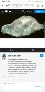

Stumbled on this....it was found in the same exact area as mine. Could be the green part?
really weird...I think the metamorphosis made the original rock difficult to identify. Sure looks like white marble, but I'm thinking your serpentinized talc may be closer to the truth. I'm thinking originally a schist or peridotite with garnets and the original host rock carbonated, so basically the metamorphosis pseudomorphed the schistoid rock to marble.
Let me be the first to say this is a WILD guess lol...but if I had to guess, pseudomorph marble after schist with garnet and some leftover pyroxene material. Or serpentinized peridotite. LOL take that with a grain of salt :D
