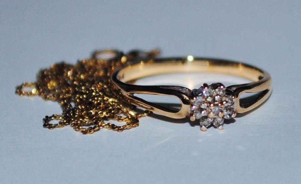

I have been doing some of fieldwork recently testing the new Garrett ATX metal detector. It was used both on land and freshwater. My initial thoughts on the new Garrett ATX PI (Pulse Induction) metal detector were quite remarkable. Now I have been using the Infinium (also a PI) since 2007 and also used the Garrett Sea Hunter Mark II for some time. They have each rewarded me with lots of gold/silver rings, jewelry and lots of coins. The new ATX is a much improvement over the Infinium. I was amazed at how well it responded to tiny conductors. Many a 22 shell/bullets and small buckshot slipped through my water scoop holes, located from decent depths. Using the 12" coil, it also responded well to various chains which I also dug from the fresh water lakes. I did manage one thin gold chain, the one shown below beside the gold ring.

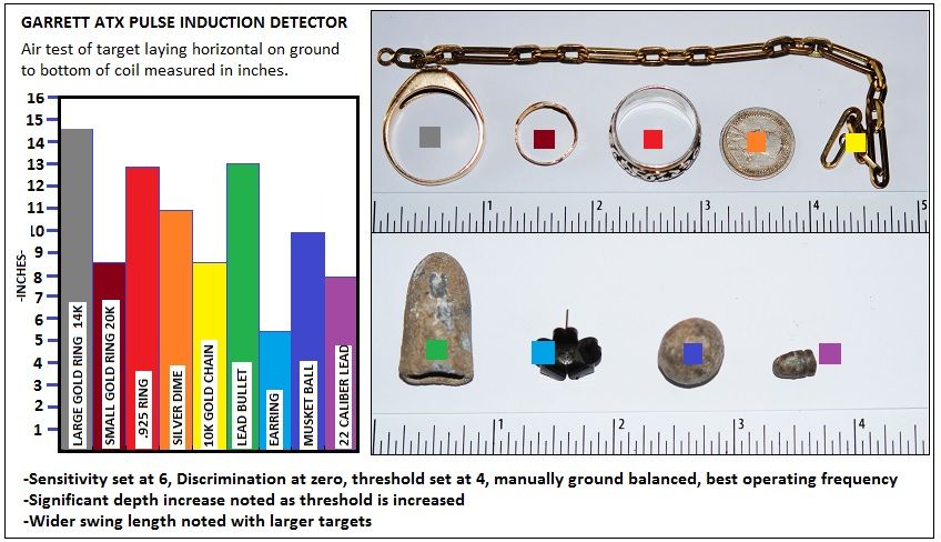

Above is my initial depth test done in my backyard in motion mode. The results are partially flawed, in that I had to deal with a lot of unexpected EMI and could not operate the ATX above a sensitivity of 6, (max @13) otherwise the target audio got lost in the EMI audio. Out in the field however, I could easily run the sensitivity near or at max with the detector well ground balanced and running with auto track turned on. And similar to the Infinium, the higher the threshold is set, the deeper the target can be picked up.
