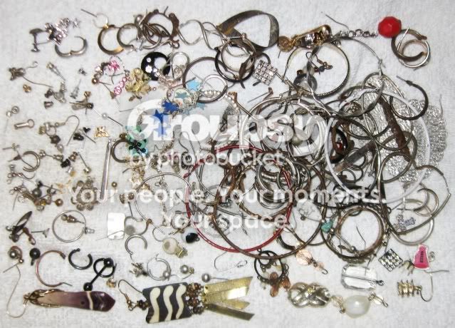

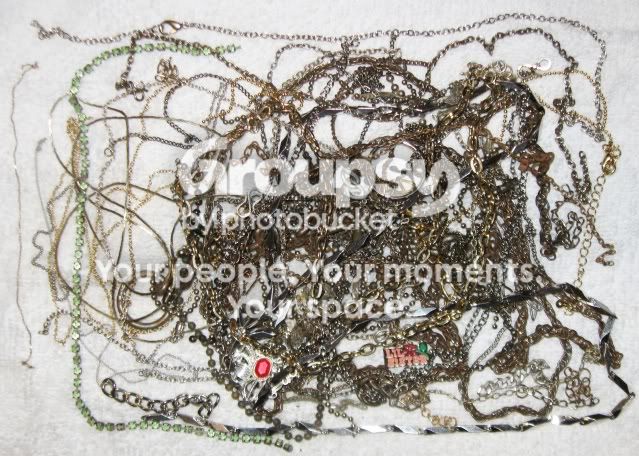

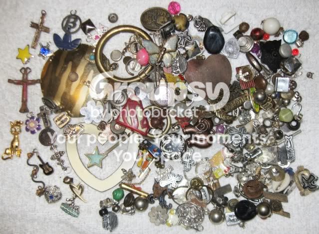

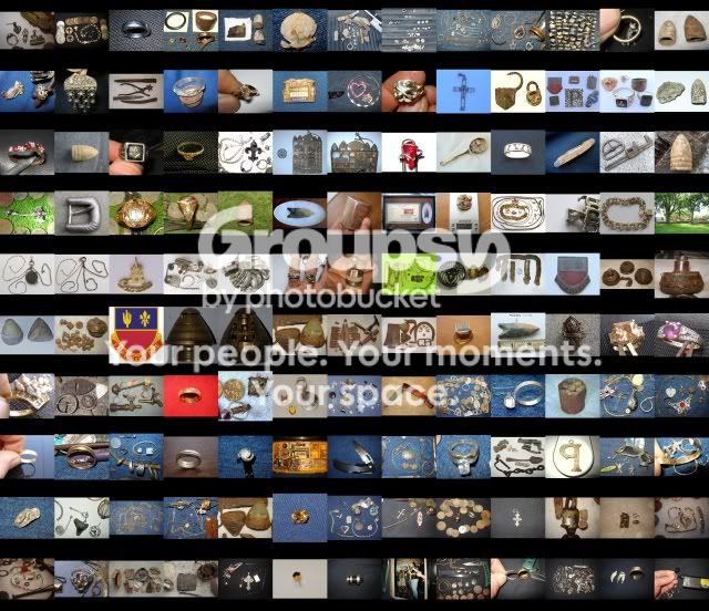

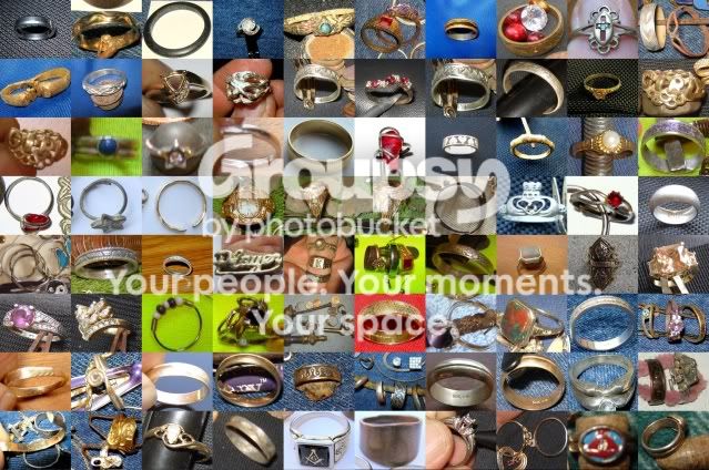

In two years I have found some stuff.
Here is a sample,
Rings
Chains
Ear rings
Pendants
And other goodies

Tabdog
